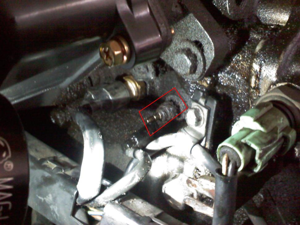

I also went to test the coolant temp sensor (by unplugging it and trying to start the car) to see if it was bad and while I did that I noticed something that seemed of concern. The wire in this photo was barely connected and I can't tell if it's a sensor that someone jerry-rigged or something else. It's on the passenger side of the engine just below the distributor and between 2 coolant temp sensors (I think). Can you tell what this is?

The sender/sensor is the "Water temp sender" (I havent' read/figured out how to attach pic's yet so you're one up on me). not sure if this is the true Honda oe number 37750-PH2-014. It works for Worldpac.....

That picture of the temperature sender... That's for the dashboard temperature gauge and shouldn't have anything to do with starting or running.
The other one in the picture (green 2-wire plug) is the temperature sensor for the fuel injection.

I think the green connector is Temp Sensor B. The one with the black connector is the coolant temp sensor that the ECU uses.
