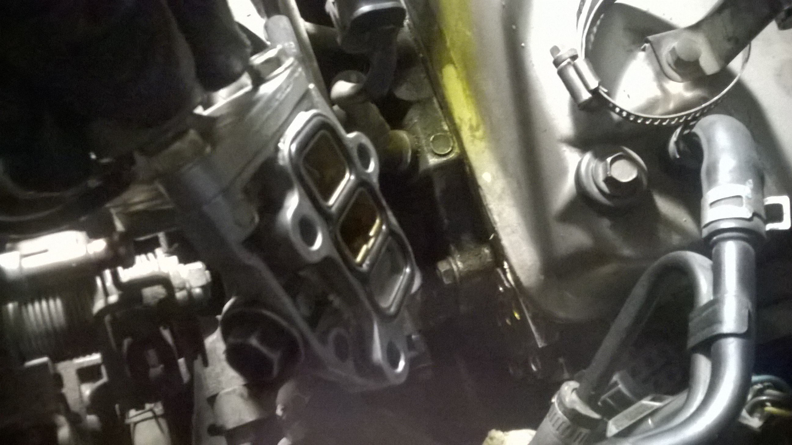

Been having the same problem, took me a while to identify this component, having to search images online to match up. Hopefully the two gaskets for the assembly fix the leak. The solenoid is at least $100 for OEM.
Anyway, here are my shots of this elusive vtec solenoid. At first, all I saw from a glance at the engine compartment was oil that seemed to come up through the gray electrical component in the first pic. I had no idea this was part of the solenoid until I searched random images of 'Honda accord oil leak,' since I had no idea of the name of the part itself. The second shot tries to show where this attaches on the cylinder head (as viewed from the passenger side looking towards the driver side). The third pic shows that I had taken apart the thermostat housing and a bunch of other air intake and lines, just to get the lower bolts (viewed from the passenger side looking towards the front, somewhat at an angle). Getting the thermostat housing is a pain just to access its bolt towards the firewall. That meant dealing with coolant. Thank heaven all of this work was all part of the coolant/radiator/hoses/distributor cap/rotor/o-ring/...water pump replacements that meant quite a job, but was all necessary.
Wish I had better shots. It's still not fully reassembled so I might re-edit to add more.
