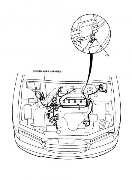

Also, remove the bolt for G101. Clean the bolt and eyelet with a wire brush or sandpaper. That is an important ground. It is located on the side of the upper intake manifold (driver's side of it to be more exact). See pic below.
