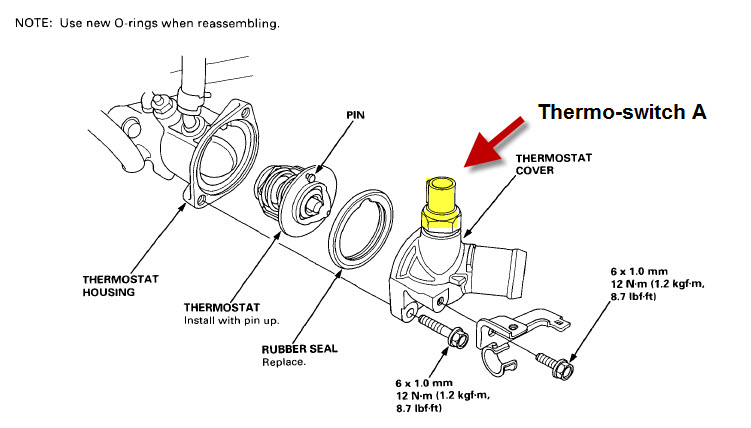

As poorman212 asked, does both fans turn on when the A/C is on? The fan on the driver side is the A/C condenser fan and the passenger side one is the radiator fan.
If only one fan turns on when the A/C is on, then we move to the next test. On the thermostat housing (lower radiator hose), disconnect the green 2P connector from thermo-switch A. Then using a small paper clip or wire jump the the green electrical connector (not thermo-switch A). Turn the ignition to ON, does both fans run now? If they do, you may have a bad thermo-switch A.
Edit: I was not reading about the same fan being on (e.g. probably radiator fan on). Poorman212 sounds right, might need to check the A/C condenser motor and other things.

Normally, when the car is on even if the A/C is off, when the coolant temperature reaches ~ 194 degrees at thermo-switch A, both fans should turn on. In your case, if everything else is working properly except for the A/C condenser fan, then only the radiator fan would be on. If both fans do not turn on at ~194 degrees, in addition to the A/C condenser fan being bad, then something else is not working properly. -- Replace the A/C condenser fan motor first.
If A/C is on; both fan should be on whether the temp. is at ~194 degrees or not at thermo-switch A.
