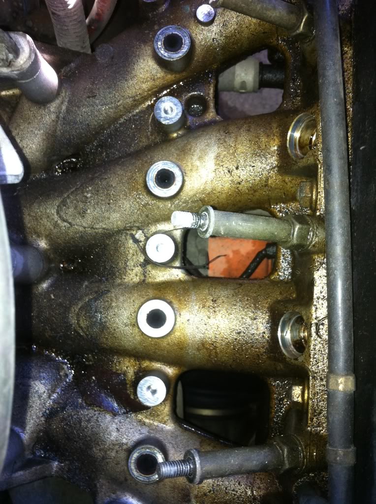

Not sure the pic will show or how large because it's from my iPhone so I can't resize it. If huge I'm sorry. Anyways, the EGR ports were clogged up tight, all 4! It still sputters a little bit but overall runs great! I bet 180,000 miles of never cleaning the EGR but in the last 10 miles it's clean. I did a crappy job but I'm getting some cleaner and redoing it but it runs good now. Thanks for all your help guys and girls on helping me on this car.
