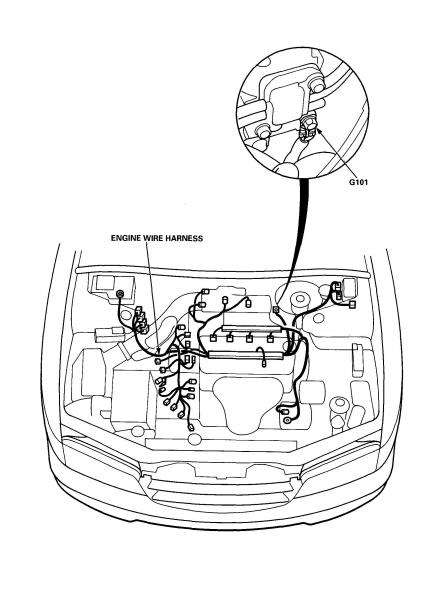

Just to be thorough, pull the 7.5 amp backup/radio fuse from the engine bay fuse box for a minute to reset the ECU. I would also disconnect the battery and clean all ends of both battery cables with a wire brush or sandpaper.
There is an important ground near the drivers side of the upper intake, so disconnect that, clean the bolt and eyelet using the wire brush or sandpaper.

Below is a picture of that important ground.
Were these problems happening before you replaced the clutch?
