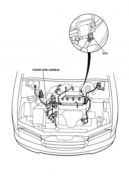

There is an important ground wire on the driver's side of the upper intake manifold. Make sure that is connected and you may want to disconnect and clean any rust with a wire brush or sand paper. See pic below.

I actually saw that ground today when I was rechecking wires (2 wires were grounded there) (it isn't far from the mystery plug, just on the drivers side of the intake instead of the drivers side of the back of the block) and checked it to be sure, but I see 0 evidence any of these bolts have been touched for a motor to be swapped out. (you can tell when a bolt has had a wrench or socket on it) May I ask what has lead you to this conclusion? It had to have been recent because as I said, the car has just 74k miles on it, and ran fine prior to the fuel pump going out of it (but doesn't appear to be a fuel issue because that'll spray everywhere if you loosen the bolt and hit the key)

Tomorrow after work I'll stop by the shop and double check the grounds and wirebrush them to make sure they're making good contact.
