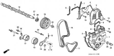

About the timing...
If the lower timing cover is OK, then the easiest thing is to use the notches in the crankshaft pulley. Use them against the pointer molded into the lower cover.
Either 1) Set your light to ZERO advance & use the set of 3 notches
Or 2) Set your light to 15-degrees & use the single notch at TDC
When I wrote that I thought your lower timing cover was messed up or not installed. In that case, you can use the camshaft marks. But the "UP" arrow is only to get the gear right-side-up. The actual timing marks are little dimples out at the teeth of the camshaft sprocket. These line up horizontally, lined up with the top surface of the head. Or the top edge of the back cover, between the head & sprocket. That back cover is #4 in the picture.
Jumpering the SCS connector is how you read error codes. But it also prevents the ECU from making any adjustments to the spark timing while you're trying to set it.

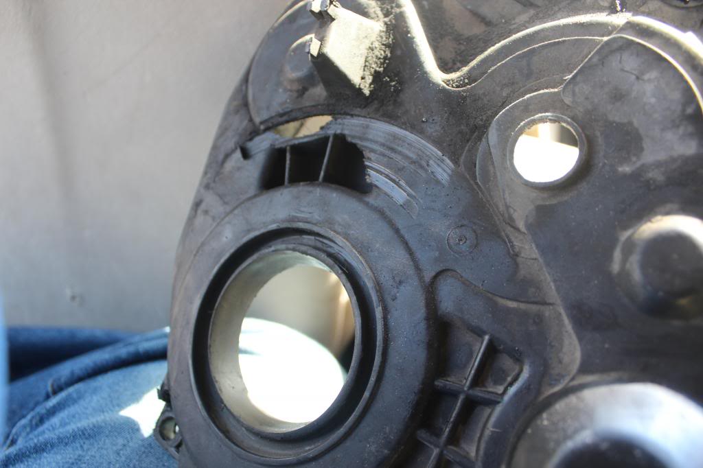

No you were right, the lower timing cover is not installed, and it is also messed up. The harmonic balancer started to rub into the timing cover and I'm pretty sure it rubbed the timing marks completely off... That, and the indicator for the timing is also missing.

Close to destroyed lower timing cover.

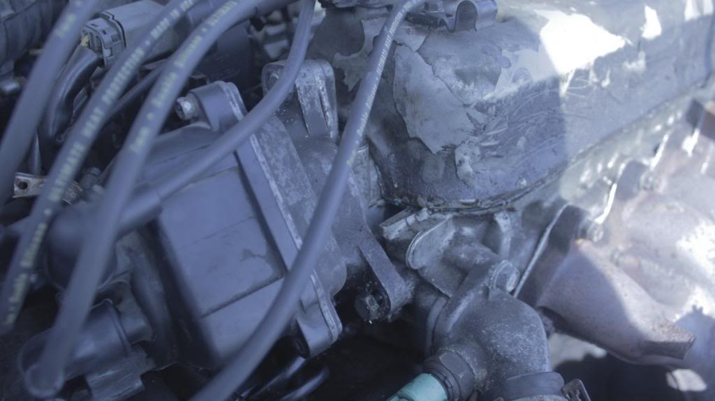

Bottomed out distributor.

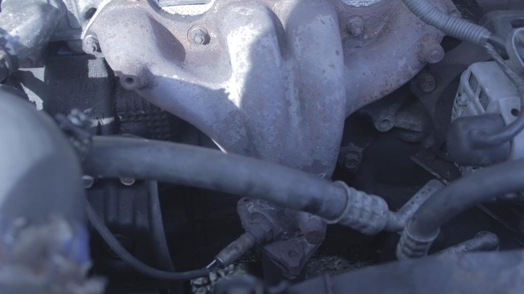

And would this be the O2 sensor in question? (For code 41)

Yes, that's the sensor for code 41. Unplug it & measure resistance between the 2 same-color (black?) wires. Should be 10 to 40 ohms. Normally its a bad sensor, but measure it in case the problem is in the car's wiring.
I don't know about needing a new distributor. I'm still not 100% confident that you're measuring the spark timing correctly. You mention the arrow on the cam sprocket, but that's often 20 degrees off. Look for the dimples in the cam sprocket and use your timing light to shine on those.
If you were to install that lower cover, the timing marks are still there. Very top & center of the photo, there's 2 posts. Kinda like an iron gunsight, the top one is a V & the bottom is a post. And the notches in the pulley are probably 1/16" deep. They won't wear off.
Another thought... one way for the pulley to rub like that is if the rubber part is coming loose. That's not a solid steel pulley; there's a layer of rubber for vibration damping. Sometimes that begins slipping. Make a mark with white paint or chalk or something, from the "hub" of the pulley right out to the rim. After driving awhile, check if it's moved.
