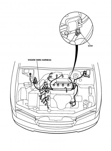

There is an important ground (G101) for the engine computer that is on the driver's side of the upper intake manifold. Unbolt that ground, clean bolt/eyelet with wire brush/sandpaper and reattach. See pic for G101 location.

Attached Thumbnails 96 Accord 4 cyl vtec won't run-pahonda-5547-albums-pics-2243-picture-g101-6236.jpg
