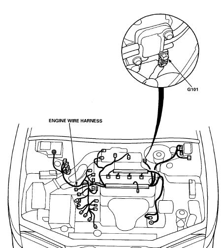

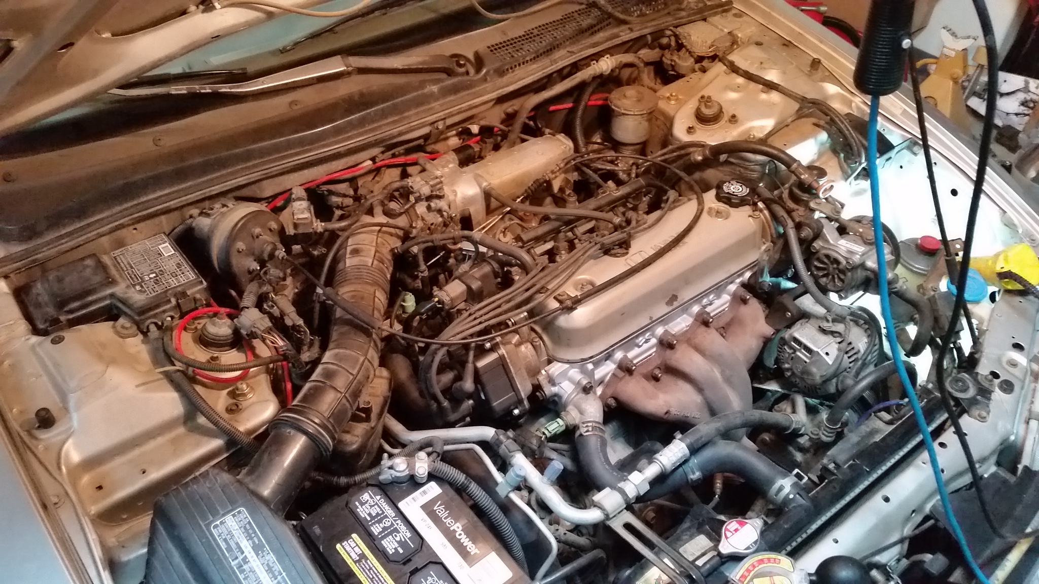

That looks like the wires for G101 and it/they (IMHO) should be moved to the drivers end of the plenum.
Once that is done be sure the battery cables are clean and tight....all ends of both cables.
Attached Thumbnails 96 Accord LX Wagon Timing Belt Damage Question-5th-gen-g101-location.jpg
Awesome! Thanks.
Heading back out to the garage a little later. vacuumed out 4 1/2 years of dust and junk. Hosed it down in the driveway. Moved it to a bigger stall in the garage.
Quick rundown of issues I've noticed so far:
1. Now the gas pedal won't do anything. Just flops back and forth. The cable thru the firewall is bound up somewhere.
2. Throttle cable/Cruise cable little nuts are off and sliding up and down the cables. Haven't found how to adjust these properly yet.
3. Fans don't seem to want to come on. Idling in garage it will eventually push the temp gauge up so something must not be flowing? New thermostat, even with heater on high it doesn't lessen the heat. All the fuses I could find under the hood, and on inside panel seemed fine.
4. Still erratic gauges/lights/slow power windows. (Haven't relocated that ground yet)
5. Power steering pump making noise. Tried both loosening it and tightening it. Squeals when loose, bearing sounds pretty loud when tight. Steering feels funny in the car just turning wheel back and forth in garage while running. I swear last night the power steering wasn't even working when I drove around the block. Seems to have assist today, but noisy.
6. All the hot neighbor ladies are starting to swarm outside in my driveway after they noticed it cruise around the block last night. I haven't found that issue in the manual anywhere yet.

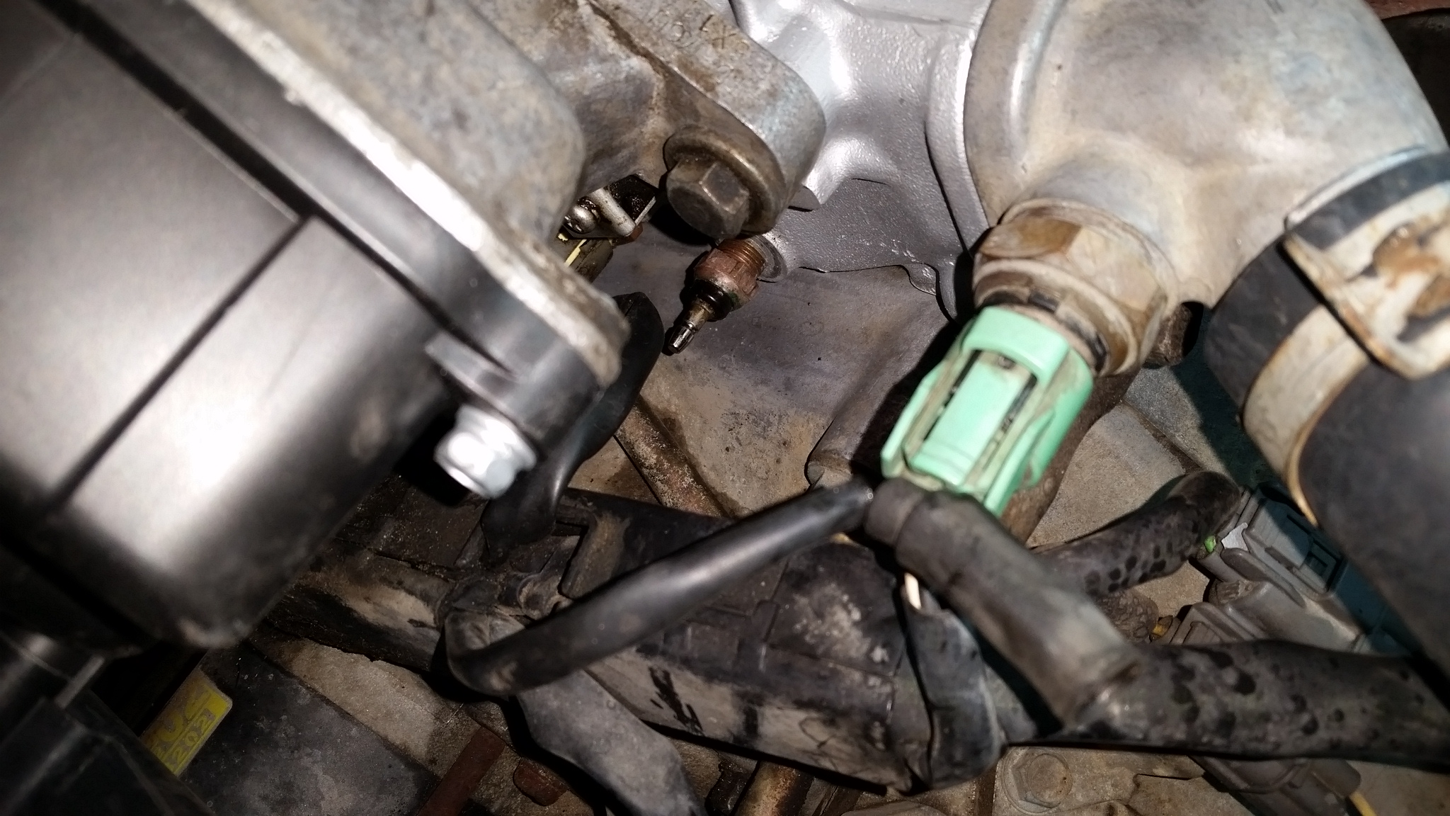

Ok, now I'm perplexed. Relocated that ground to the plenum. Not sure if it's related at all, but my throttle cable is smoking and melted. What the hell would cause it to get hot enough to melt the casing and actually smoke? That might explain why the pedal doesn't move the cable at all if it's melted into goo.
Also noticed my banjo fitting on the fuel line is leaking a little. Washers crushed maybe?
Before I noticed the smoking cable, I sat in the drivers seat with it running and the lights on. Tach idled fine until I pressed on the brake pedal, or turned the heater control **** on. Then drops to zero. (Just the tach, not the engine). With the gas pedal all loose, the lights flicker and flutter just by moving the gas pedal too.
Also tonight, new battery, clean terminals.

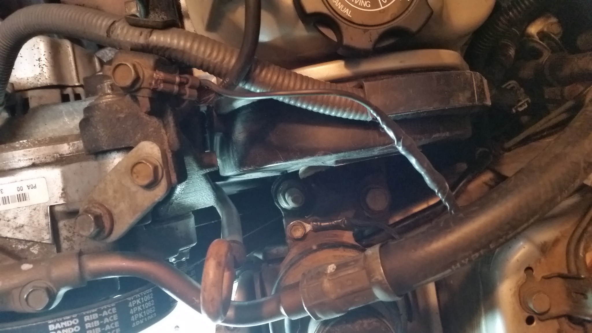

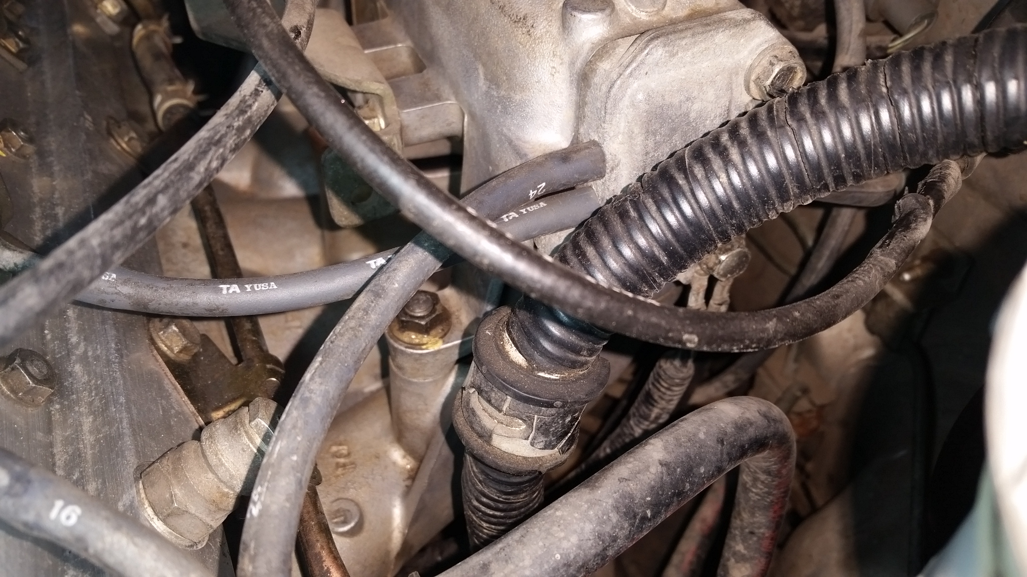

Just realized I left this sensor (2nd pic) unhooked after I cleaned it tonight and it was shortly after starting it and letting it run that the cable started smoking. Distributor feels hot too.
This is becoming more frustrating by the hour.
Ok, this post is exactly what I was experiencing. Combined with what you said about the g101, does this help narrow it down?
http://honda-tech.com/honda-accord-1...rical-2567060/
Attached Thumbnails 96 Accord LX Wagon Timing Belt Damage Question-20151028_003540.jpg   96 Accord LX Wagon Timing Belt Damage Question-20151028_001819.jpg

Did you lose a ground wire? If the engine block is grounded to the car body through the throttle cable, that would explain the heat.

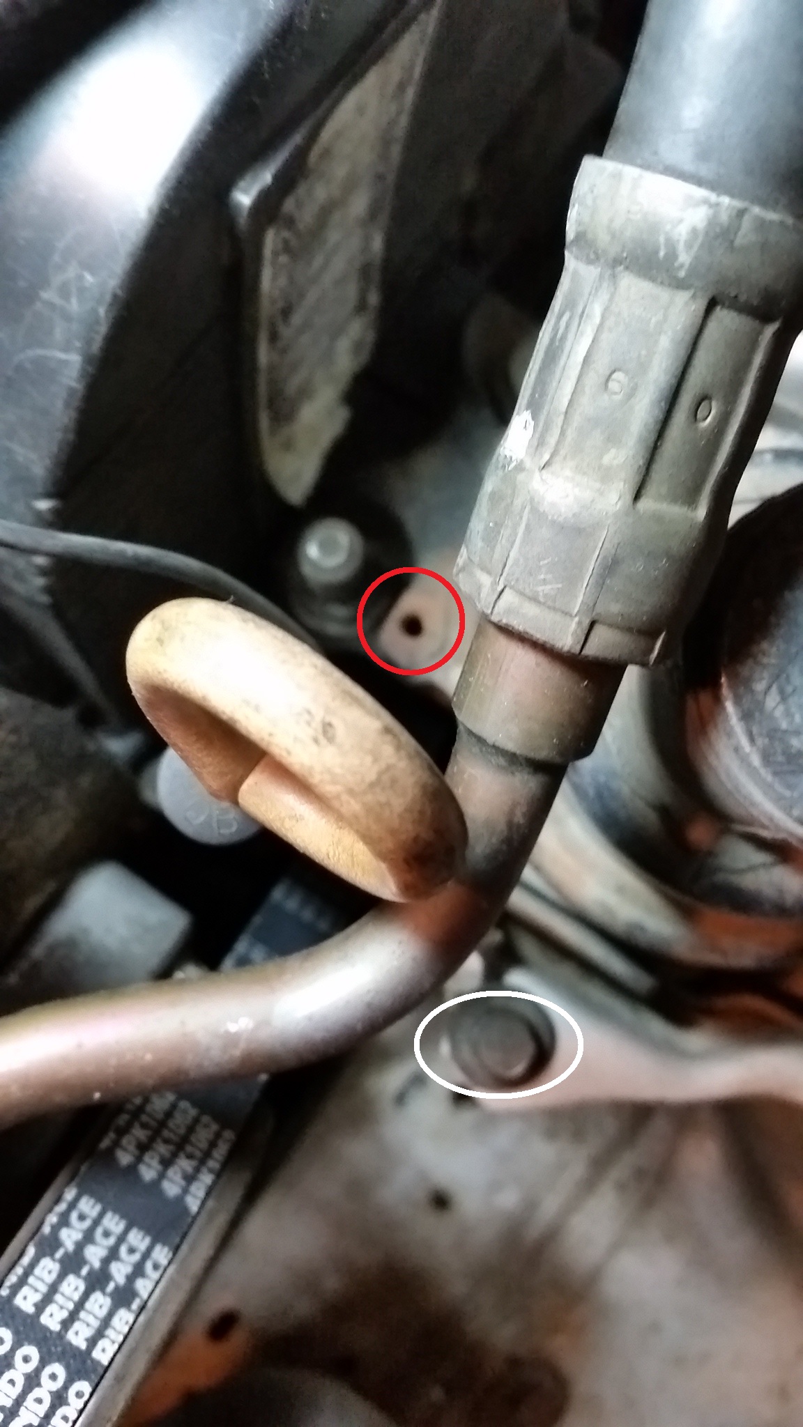

Should the white circled bolt be grounded to the red circled hole in the power steering pump bracket? It looks likes something was attached there before. I only attached it here because it looked like it fit.

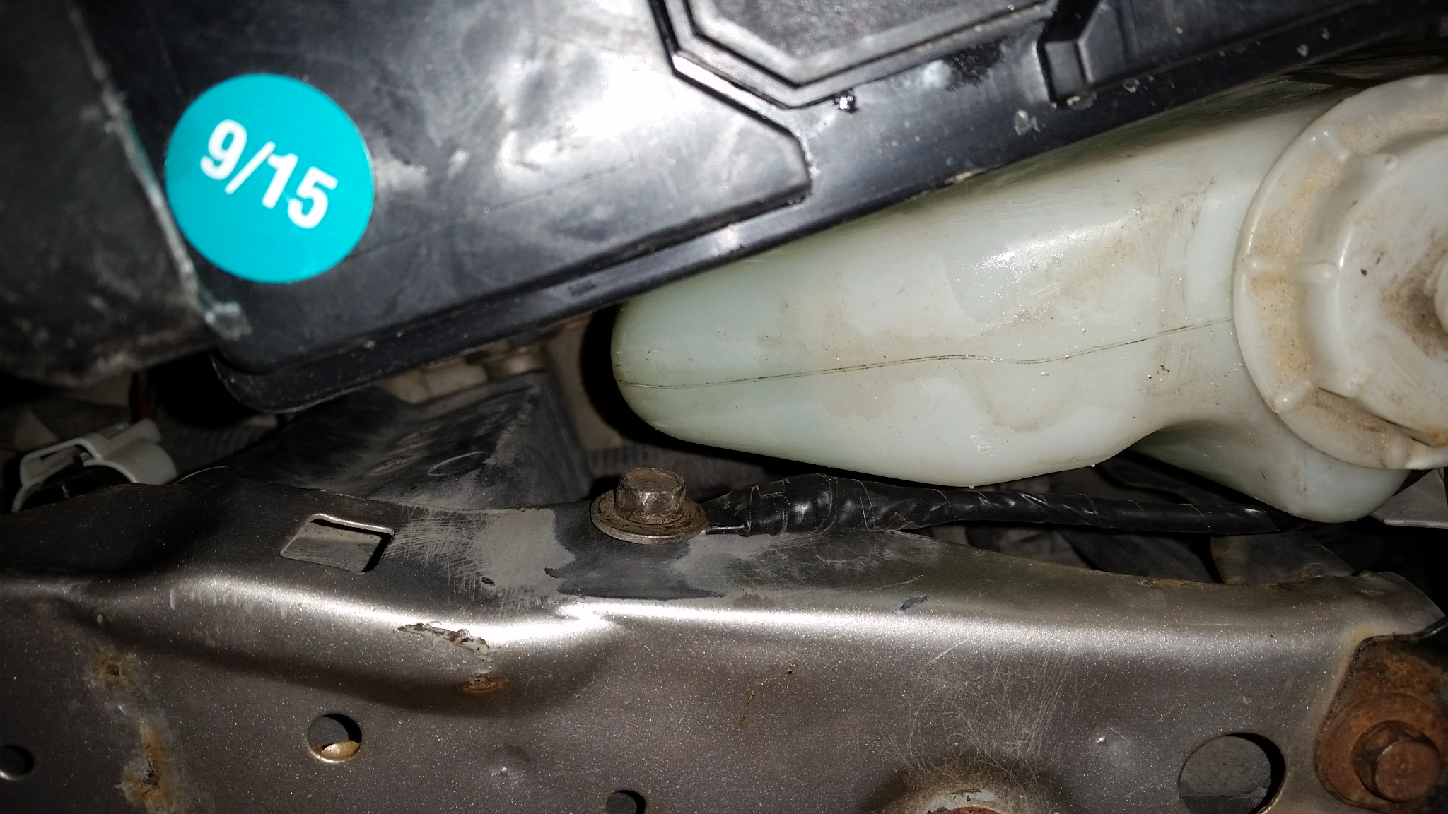

Well I don't know which of the things I did actually fixed it, but it runs perfect now. I moved the PWR steering ground from the painted body mount to the motor mount bracket. I also sanded all the connections. I cut the ends of the pwr steering ground and crimped new ends on it and also the small battery ground wire. Purrs like a kitten now. Just needs the new throttle cable tomorrow and hopefully were ready to roll.
Attached Thumbnails 96 Accord LX Wagon Timing Belt Damage Question-20151029_010925.jpg   96 Accord LX Wagon Timing Belt Damage Question-20151029_011026.jpg   96 Accord LX Wagon Timing Belt Damage Question-20151029_011044.jpg   96 Accord LX Wagon Timing Belt Damage Question-20151029_011017.jpg
