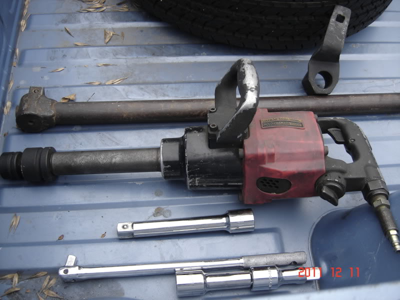

Big Bertha says that bolt is a puny girly-man, and laughs at it.
Attached Thumbnails 96 Accord - Stubborn Crank Shaft Pulley Bolt-timingbelttools001.jpg

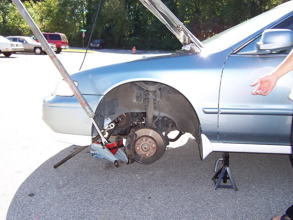

I always used this method with 1/2 impact extensions, 1/2 19mm impact socket, and the Honda Crank Tool that you can rent from part stores. Also, place a jack stand underneath where the extension and breaker bar meet. I have used this method on about 15 Honda/Acuras, no issues.

Very nice thats almost exactly what I did. The only difference was I put the spare tire on and turned the wheel to one side that allows the extension to come straight out. I had enough force on the bar to move the car which made me nervous using a jack stand.
