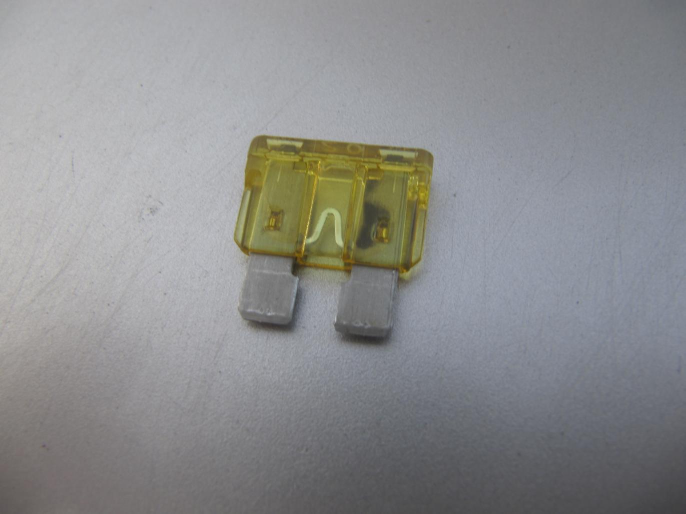

Anyway, I took a look at the fuse and noticed that it has a very dark spot on the right side of it. The wire is still intact but part of it appears burned to me. I've attached a picture of it. Does this look not right to anyone else?
Just to test, I swapped the fuse with another fuse and the fan came right on once it got up to temp. Climbed just about 1/2 and clicked on.
I'm still inclined to think that there is an underlying issue if this fuse is not good.

I'm a volt meter or test light person......means I'm blind as a bat. Fueses are cheap....put a new one in and go from there.
