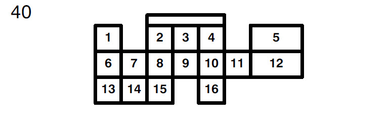

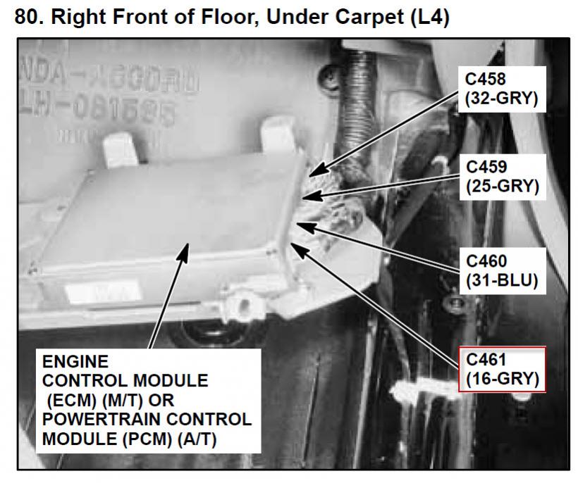

10. Connect ECM/PCM connector terminals D7 and D11 with a jumper wire. (terminals D7 and D11 is at the 16-P gray Connector C461) -- Terminal numbering is counting from wire side of the female connector C461.
11. Turn the ignition switch ON (II).
12. Check the Primary H02S (Sensor 1) output voltage with the scan tool.
Is there 0.9 V or more?
YES-Substitute a known-good ECM/PCM and recheck. If the symptom/indication goes away replace the original ECM/PCM .•
NO-Repair open in the wire between the ECM/PCM (D7) and the Primary H02S (Sensor 1) .•
