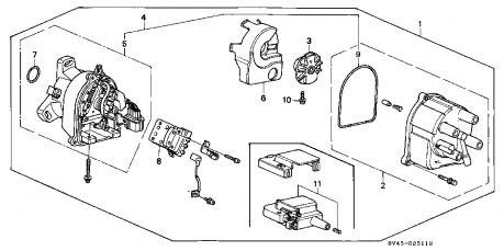

If you're referring to part #6, that is a leak cover.
Attached Thumbnails 97 Accord SE Distributor Question-distributor-tec-461708.jpg
