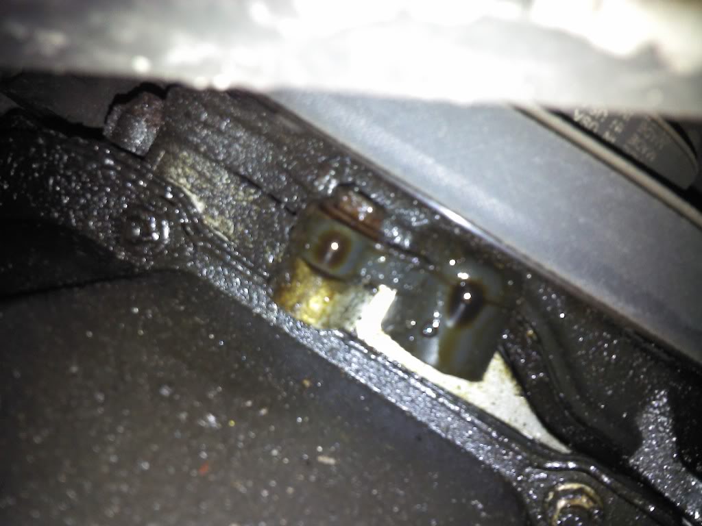

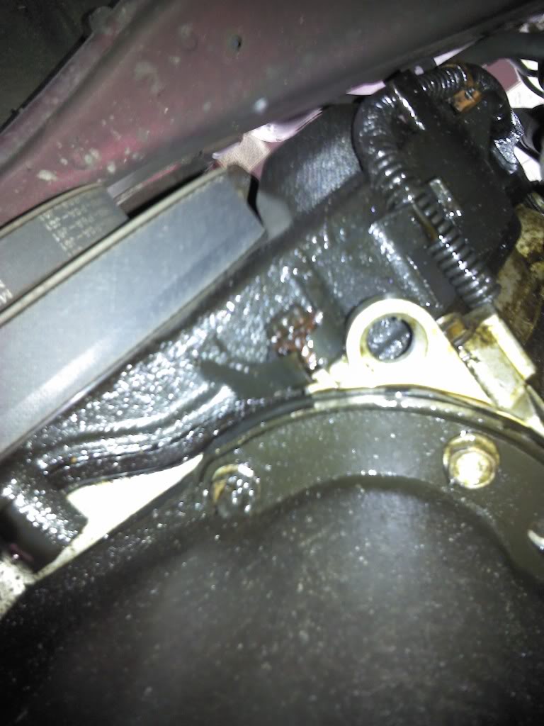

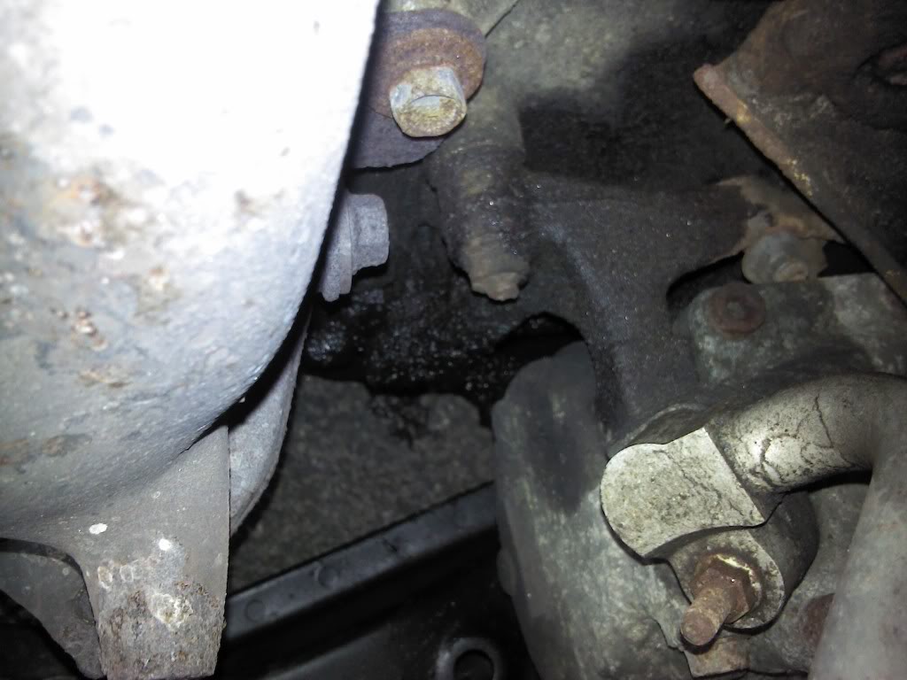

here are 3 pics...
1st is from above, youll see exhaust manifold to the left
next pic is under car belt side front...
last is belt side rear...

Now.
Pic one looks like normal build up from an oil pan leak.
Two could be "drippage" from three.
I'm beginning to worry that this might be from a valve cover leak, yes I know you replaced it but those corners where the head makes a 90 degree turn to the "cam hump" are usually a place where leaks happen.
