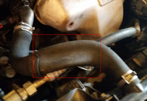

Once I got home I opened up the hood and noticed that the radiator hose seemed to be suctioned out indicating some sort of negative pressure. This morning I removed the radiator cap and confirmed that there was some negative pressure in the system.

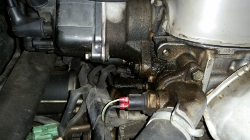

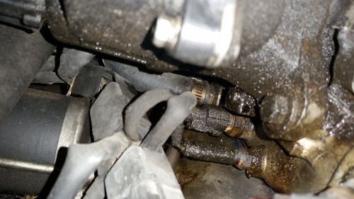

I didn't test to make sure both fans are running yet, but I did snap a couple of photos just under the distributor (where the ECT is supposed to be located). There seems to be some leaking going on there, but I'm not sure what yet. I haven't spent much time doing any diag yet as I wanted to get the forum's input before starting.

Jake, the oil leak around the distributor is likely the distributor "o" ring. I've replaced plenty of them for that exact reason. Easy repair. As for the cooling system, if you have a suction there, in the upper hose, the cap isn't venting. However, your over heat problem is separate from that. You'll need a new radiator cap. My guess is the fans aren't turning on. Could be the temp sender, or the fan relays in that case...or even the fuse for the fan relays....sean

Distributor O-Ring: Sounds like an easy enough repair
Suction in upper radiator hose: I had a feeling it was going to be the radiator cap; thanks for confirming!
