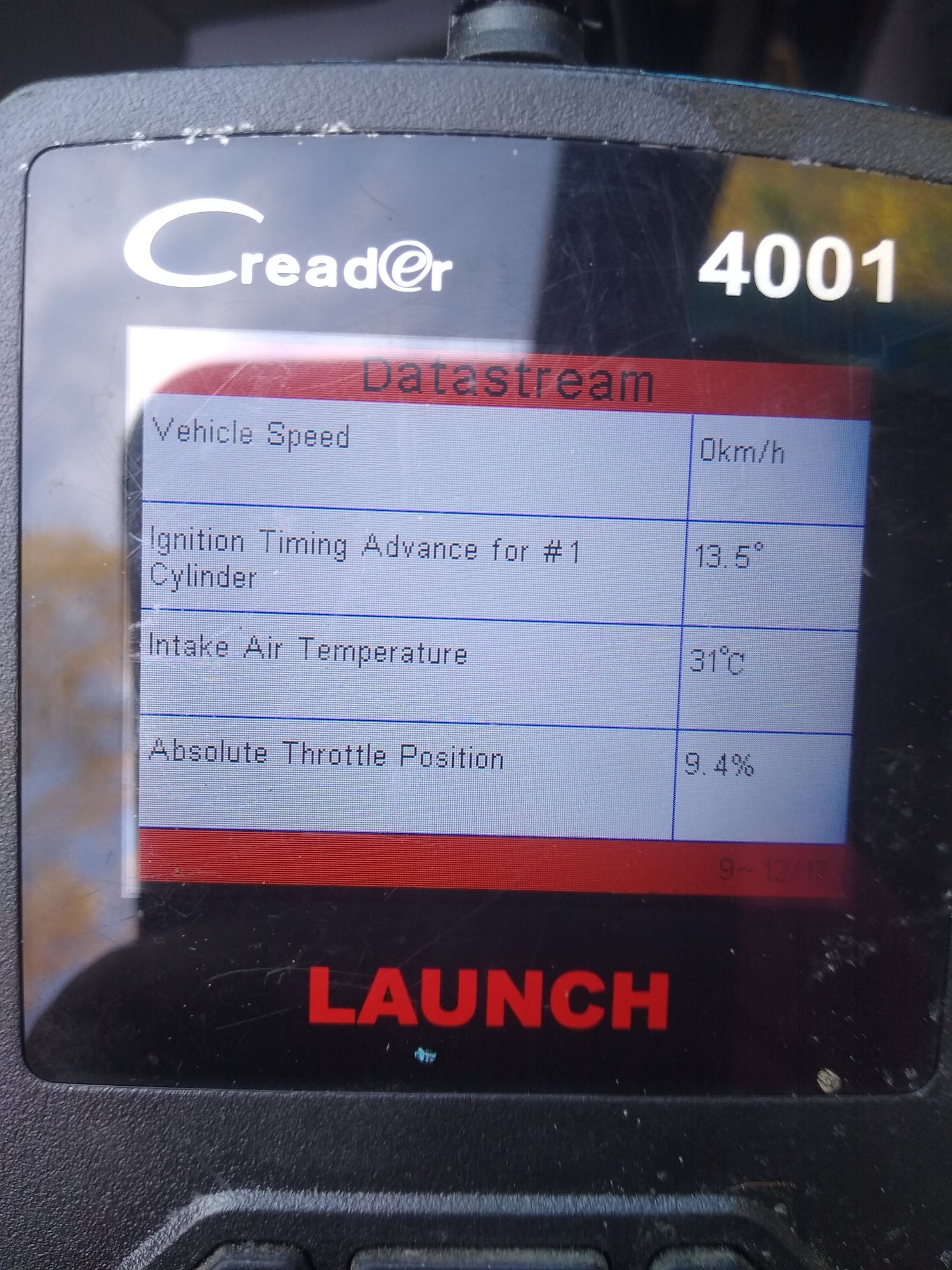

Ok so from battery positive to fuse box I have 0 volts from negative on battery to body ground I have 0 volts I have 12.5 volts with vehicle off and it drops to 12 when cranking I've cleared the codes and the only one to return was p0505 I'm going to attach a picture as well of what the scanner says this was taken at idle

It seems my throttle position is at 9.4 at idle and the map pressure say 37.0kpa if that has any correlation to my issues and wide open with vehicle off throttle is 89.4 percent and with vehicle off manifold pressure is 91.0kpa?

The MAP readings seem ok to me (5 psi at idle and 13 psi at WOT). Was you outside air temperature around 88F when doing this test?
The TPS may be normal. With the engine not running, slowly press the gas pedal and see if the TPS reading slowly increases.
