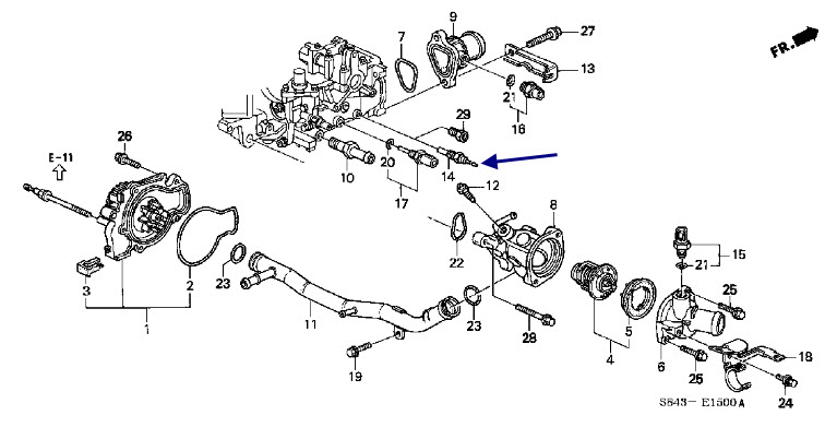

In regards to the temp sensor for the gauge, for your car I believe it is under the distributor. Refer to image.

redbull-1.....thank you for the picture. How do I bleed the air out of the coolant system?

Part #12 in that picture is a bleed valve. When the engine is cold, loosen it to let the air out. Then top up the antifreeze at the radiator cap.

Thank you much for the help (diagram pointing out the appropriate parts was essential)!!!!
