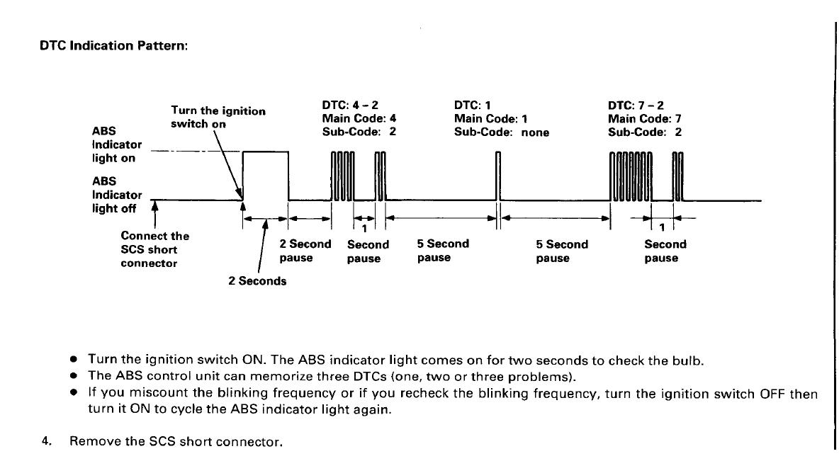

Ok - I thought a bit more about how your description might be an ABS code. Please recheck the code after reading the link and the attached.
Best I can come up with is a code 1 with no subcode...or maby a 1-1 code. If my guess is correct, start with check the brake fluid level in the ABS UNIT - not the brake master, the ABS unit. Then you should bleed the ABS UNIT.

When you tell us a code, also tell us the light, because a CEL code 32 is much different than an ABS code 3-2.
Look at the picture poorman posted. When you turn the key, the ABS light turns on for about two seconds (bulb check, so no code), 2 second pause. Then you get the main code, 1 second pause, then the sub code.
There is a 5 second pause between new codes.
Let us know what you find.
Old Mar 23, 2013 | 09:33 PM
Something's strange, because in 94 the ABS codes aren't long & short flashes. Like the picture Poorman shows, they're all short flashes. It's long & short pauses between flashes.
