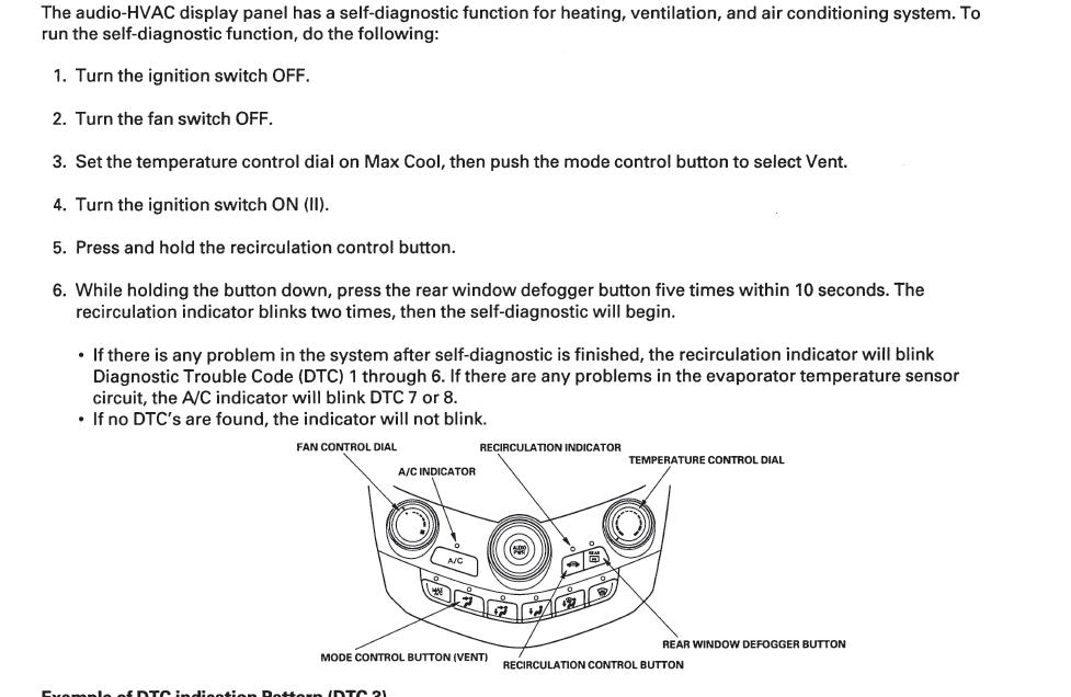

Just went out and did the test I dont know exactly how to read it though, at the beginning of the test (immediatly after I hit the defogger button 5 times) the recirculation indicator flashes twice. Then I stays on constant for several seconds what seems to be the length of the test. There are no flashes at the end of the test.

I'll do that as soon as I can probably tomorrow, but did the test show as 2 blinks or was that considered 0 blinks? Thanks again

Can't really tell - does this car have the "auto HVAC" - again hard to tell from the video.
no theres not an Auto HVAC button, if thats what your asking
Old Jul 27, 2013 | 12:06 PM
Ok, wasn't sure........are these the instructions you are following?
Also, please check as PA suggested.
