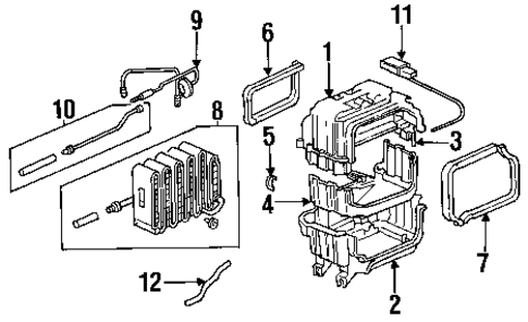

Have you checked the ac thermostat? Location is behind the glove box. I had a similar issue earlier this year. Culprit was the ac thermostat. Will see if I can find a picture.
Old Jun 5, 2016 | 09:59 PM
djkurious's Avatar
Joined: Jan 2012
Posts: 211
From: Nashville, TN
Attached Thumbnails AC troubleshooting, ac diode location?!-62797b81f7740b6347f58ecc7867e8f7.png
