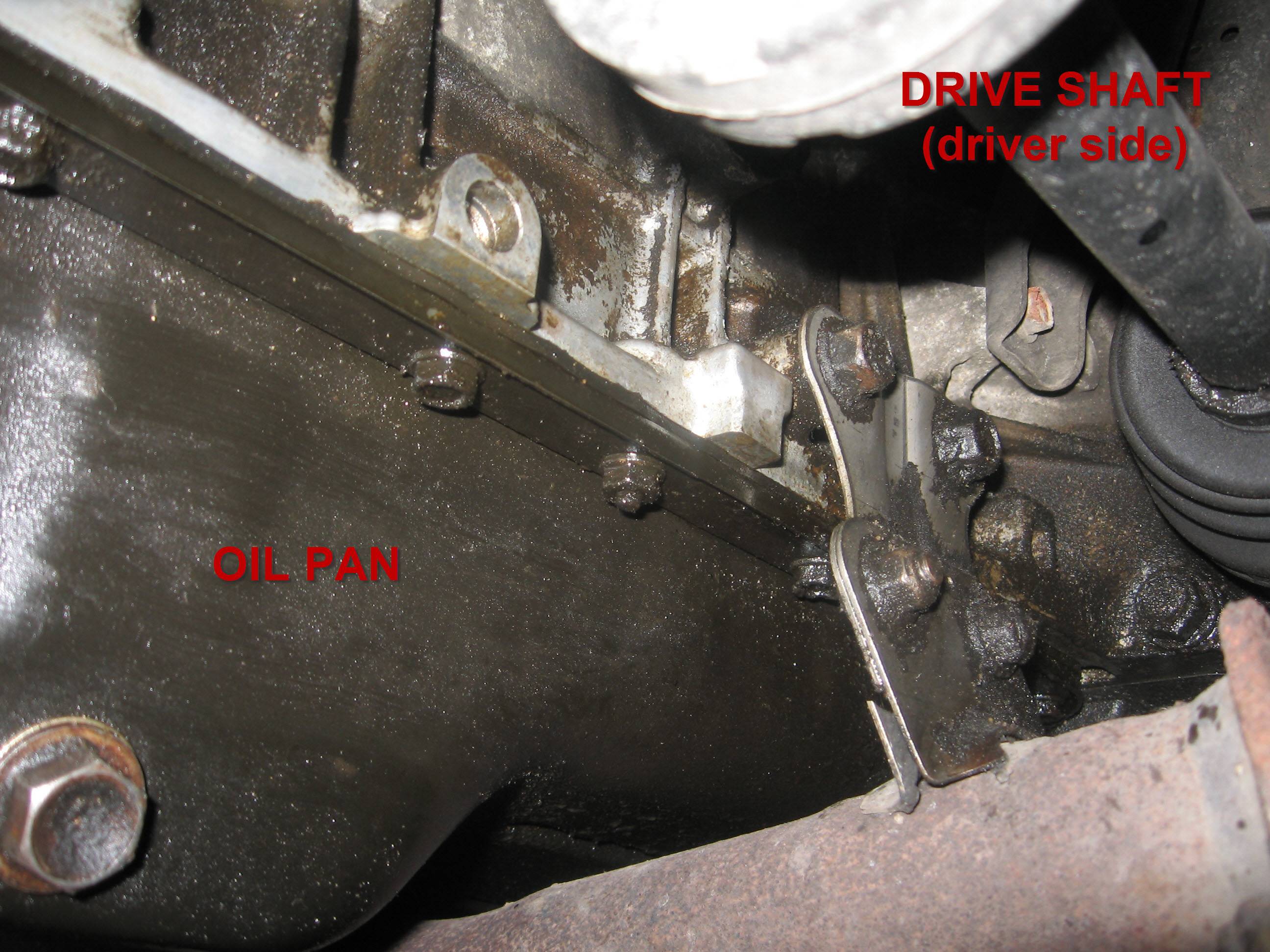

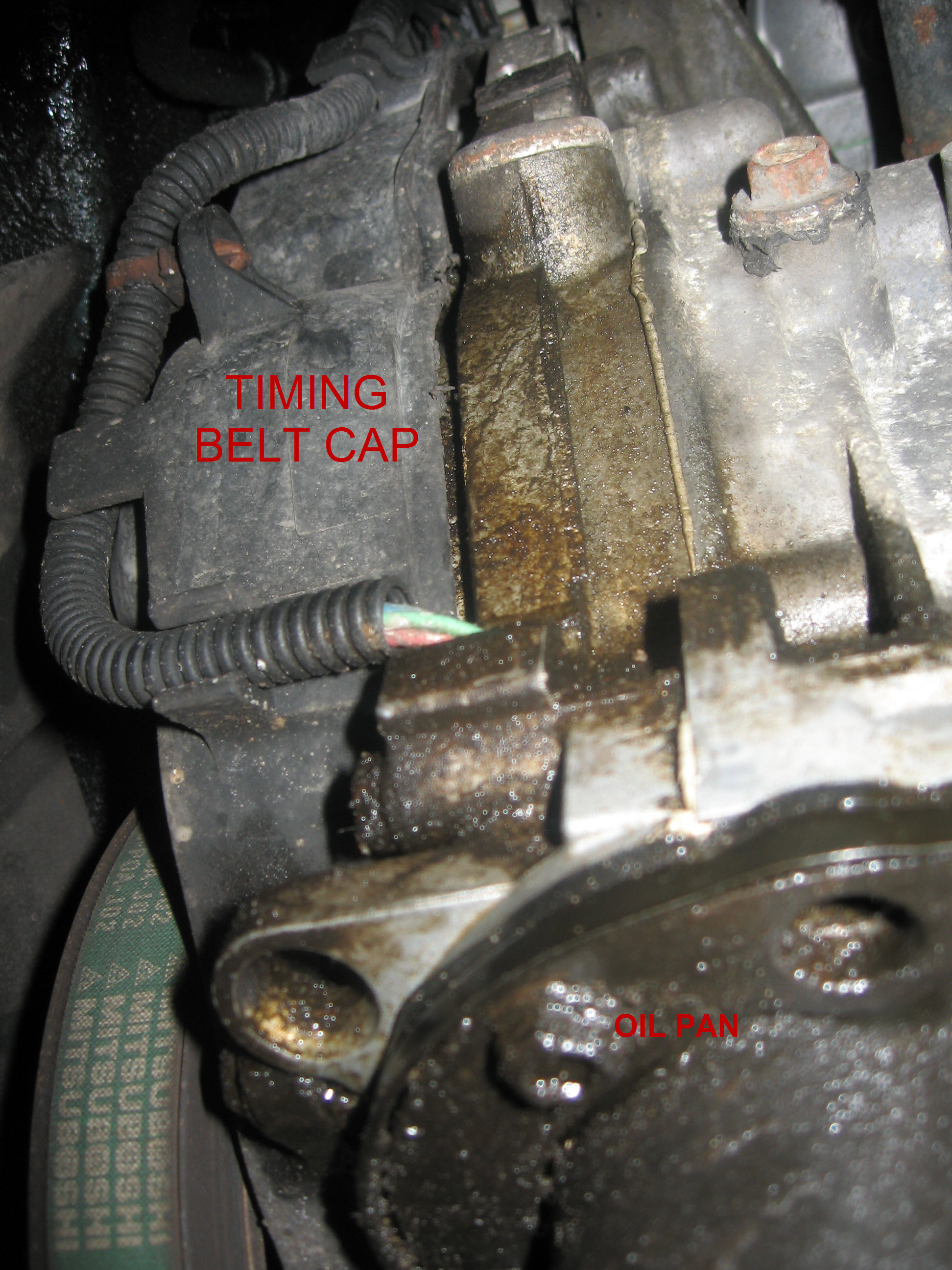

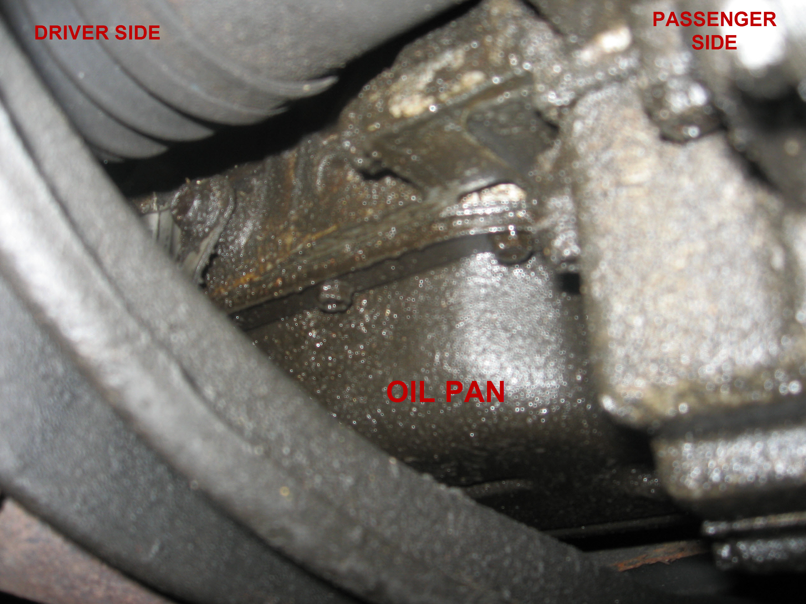

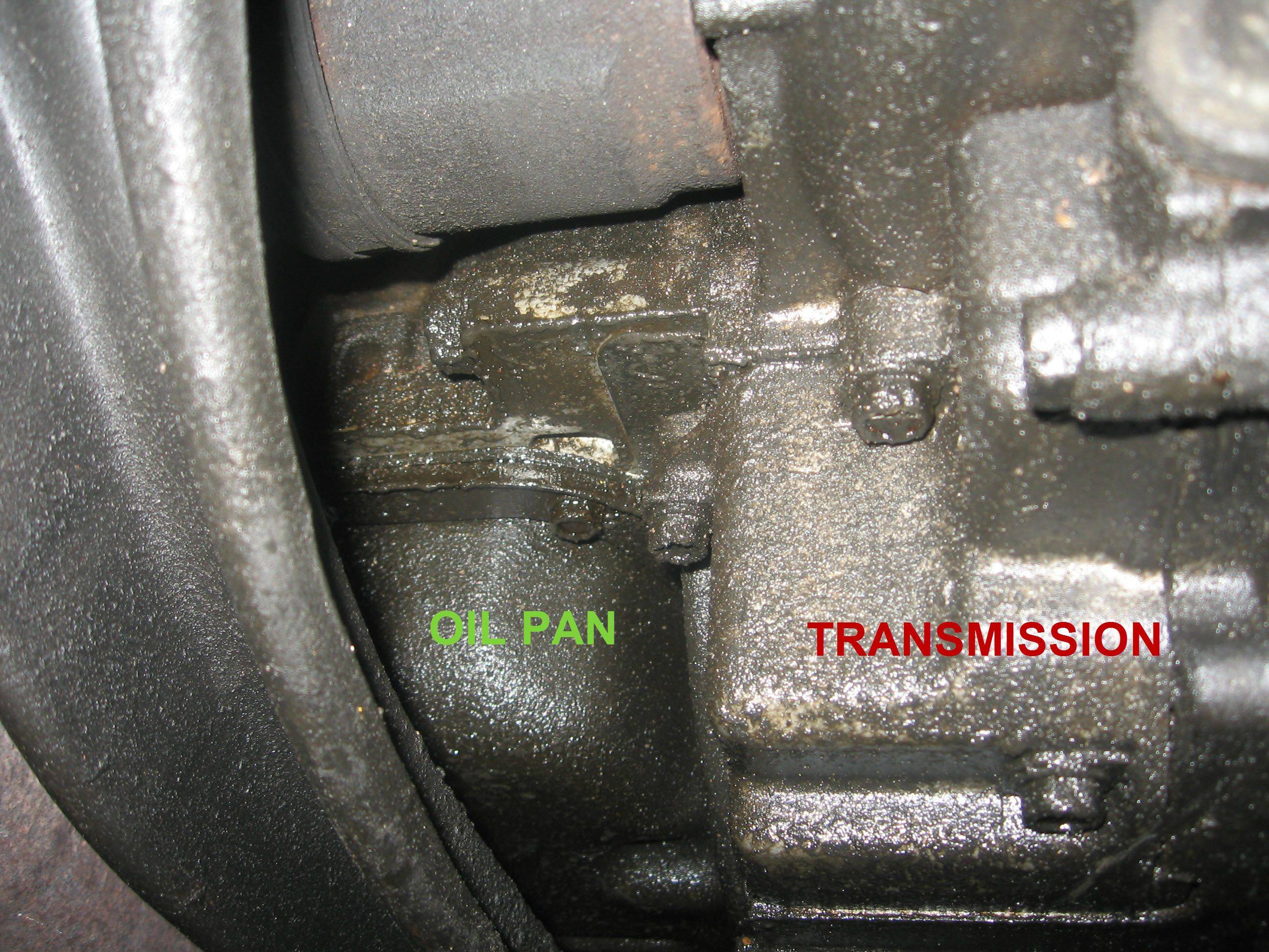

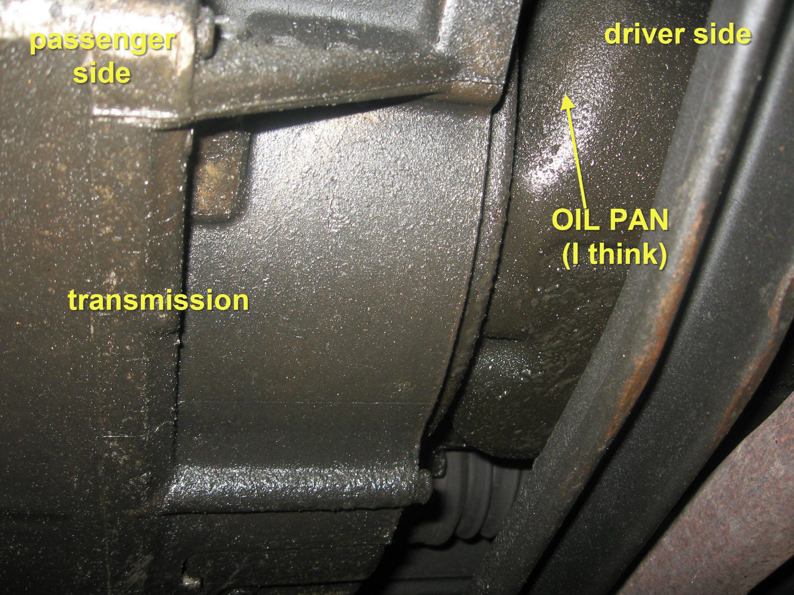

Thanks PAHonda, I followed your recommendation and also took some picture. I cleaned all that mess and sprayed some powder and in a couple days I will check again.
Response 1 : For your questions, I changed the distributor o-ring seal a couple month ago since it was leaking too and now it is fine , no leak at the distributor.
Response 2 : I didn't change the oil since 5 months.
On the 3rd image , I completely forgot and already cleaned a little bit before taking the pictures.
II am surprised with all that oil on the motor, I only have about 5 drops on the ground.
It is hard to see where the leak come from, at least for me.

One other important item is to check your oil level and add oil when necessary. I'd keep a quart in the trunk in case of emergency.
Some of that oil on the passenger side/transmission may be left over from the distributor. Cleaning up should help out.
For now, I'd rule out the oil pan gasket, because there is a leak above it on the driver's side of the block. Look under the valve cover gasket on the driver's side of the engine. That leak may be from one of the seals behind the timing belt cover. When are you do for a timing belt change?

There are 3 shaft seals and 1 o-ring. The front balance shaft, the camshaft, and the crankshaft seals could leak. The o-ring is for the rear balance shaft housing.

So I checked again today, and the oil leak is from under the timing belt cover (see Image 1 above).
So I guess I have to check exactly which seal is leaking .
Do you have any recommendation on removing the cover ?
Is it worth to repair that oil leak ?
If I decide to not repair the defective seal, how safe is it to continue to drive ? I mean could the seal break and all the oil is coming out suddenly ?
