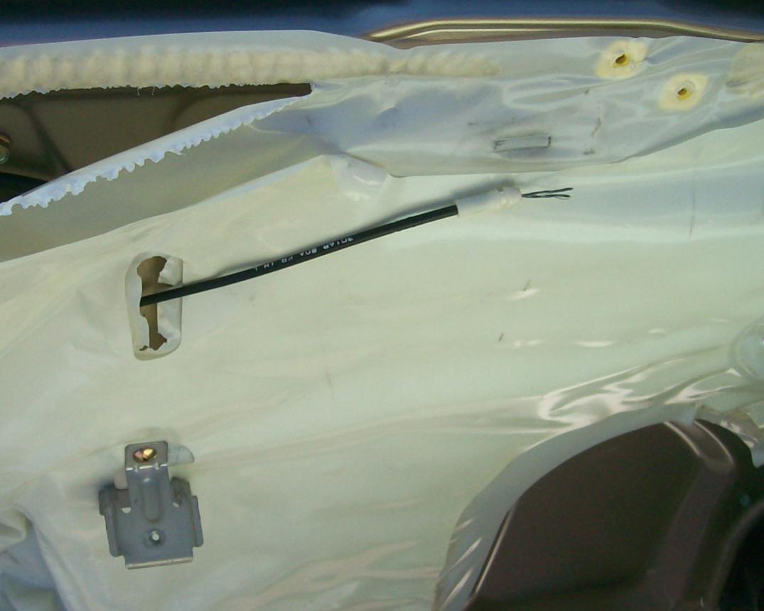

The inside door handle on the driver side of my Accord 2003 does not operate the door mechanism anymore. I had to get out on the passenger side today. I can open the door from outside but not from inside. I am going to open the darn thing and look inside to see what's is broken. Anyr instructions/tips to remove the front door panel of a 2003 Honda accord? I searched the forum and only found instructions for a 2000 rear door.

OK well I found out how to remove the door panel. Very easy actually. Now I can see that the door handle cable is broken.

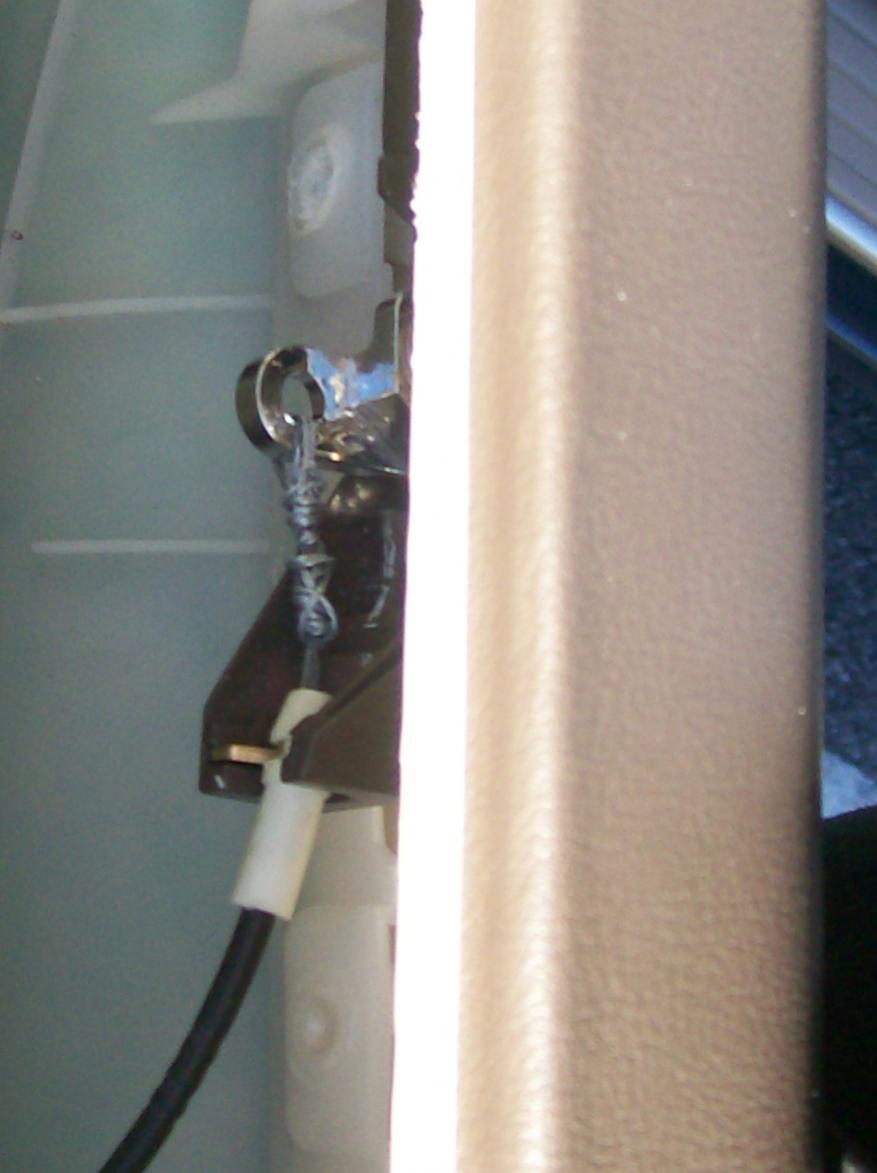

Fixed my broken cable without having to replace it. All together 1h of work

I used a thin metal wire that I crimped on the original cable. The first pic shows where the cable broke. The second pic shows the repair I made by crimping the metal wire and attaching it to the back of the door handle.

well done! a nice DIY solution without incurring the cost of a new cable.
