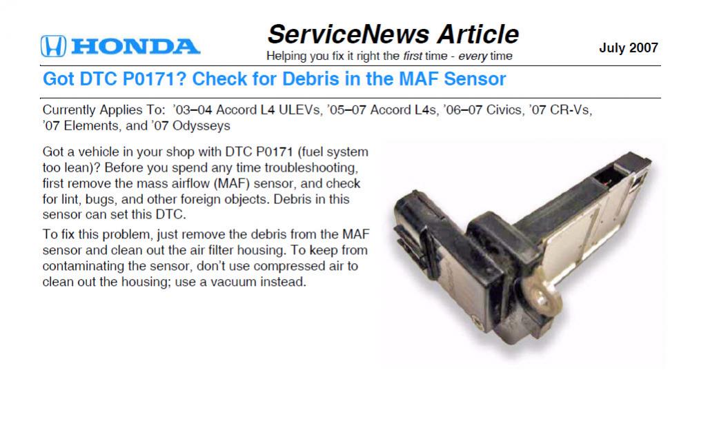

For P0171, check whether the MAF sensor is dirty. If it is, CRC makes a MAF safe cleaner.
Attached Thumbnails Accord 2005 O2 Sensor replaced Light came back on-p0171-maf-sensor.jpg

I went and bought the CRC sensor cleaner planning to clean today.
Okay, so now I need to update with a bit of embarrassment here. At the same time I changed the downstream O2 sensor last week I also changed the air filter also. I remember it was tough to get the air hose box off. So, anyways I notice it appears a hose was loose and had come unplugged in the hose. As long as I had cleaner I took it out anyways, it appeared pretty clean but I sprayed it several times anyways. Check engine light is gone, probably the loose hose but glad to learn about the sensor here in forum and I'll clean each time I change air filter as it is touted as possibly aiding with mpg. Never used a forum before and want to thank all the folks here and the great moderators for what appears (keep fingers crossed) to be a happy ending.
