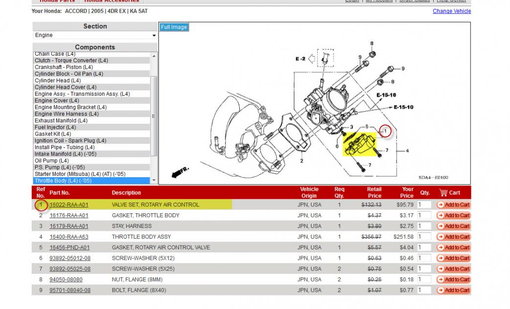

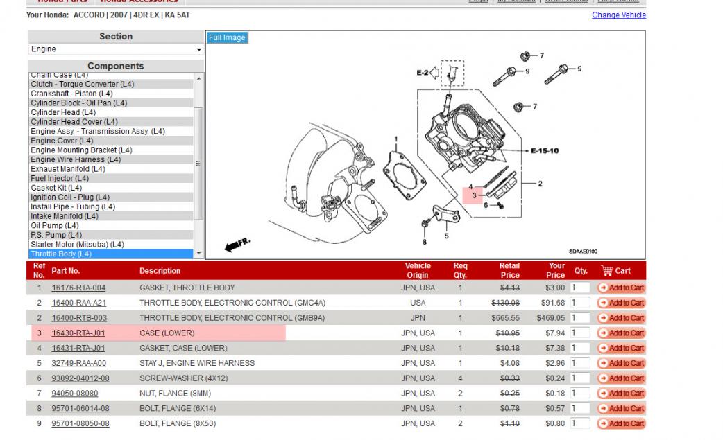

The 2007 Accord 4 cylinder has the drive-by-wire throttle system (electronic throttle system). I don't believe the 2007 has an idle control valve.
(2003 - 2005 Accord 4 cylinders do not have drive-by-wire throttle control systems, whereas 2006-2007 4 cylinders have drive-by-wire throttle control systems.)

The 2003-2005 Accord 4 cylinders had a rotary air control valve as part of the throttle body, the 2006-2007 Accord 4 cylinders did not have that, it is only a case cover there for the 06-07. See attached pics comparing the two different throttle bodies.
The service manual may have shown it, as generally, they cover several model years.
