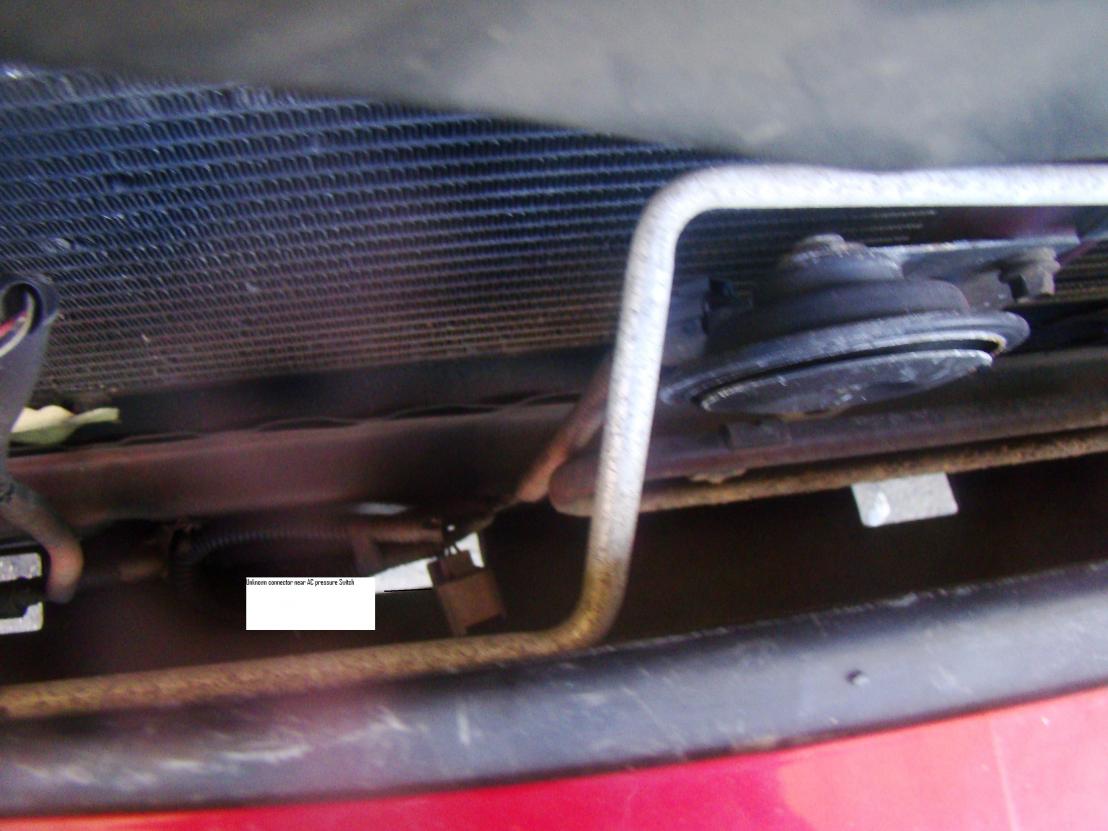

In this picture: https://www.hondaaccordforum.com/for...d-advise-2-jpg
Is that a shadow or is that discoloration on that a/c line?

this is a AC line infront of condensar. underneath that there is a 2P electrical connector which has nowhere to go. where that connector goes?

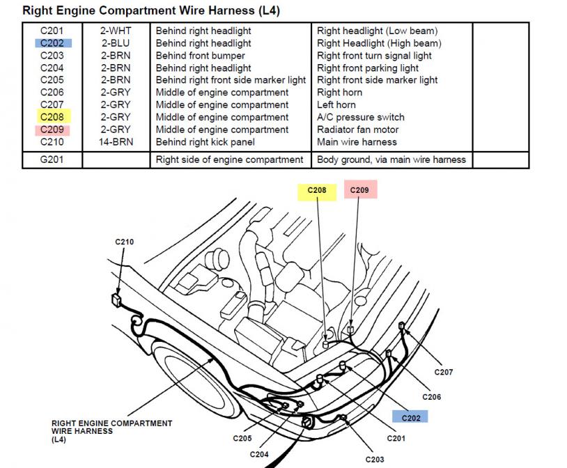

North America (i.e., USA and Canada) circuit and wire routing diagrams do not show a gray 2P connector with a Red/ wire and a Brn/ wire near that area. The A/C compressor clutch is in the left engine compartment for North American 1995 Accords. The only gray 2P connector near the gray 1P compressor clutch connector is for the A/C condenser fan motor.
Your Australian RHD has differences; for example, you have no EGR valve. In one of your pictures, it shows a blue connector. If the A/C compressor clutch connector is blue, then that is another difference (US Accord have a gray 1P connector).
The wiring colors for the gray 2P connector you have would also be different than for USA Accord fog lights.
