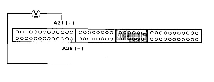

Try the following:
With the ECM plugged back in, measure voltage by backprobing between ECM terminal A26 (Brn/Blk wire) and A21 (Yel/Grn) wire, with the ignition switch ON. The Brn/Blk wire is ground and the Yel/Grn wire is the Ignition Output Signal to the ICM.

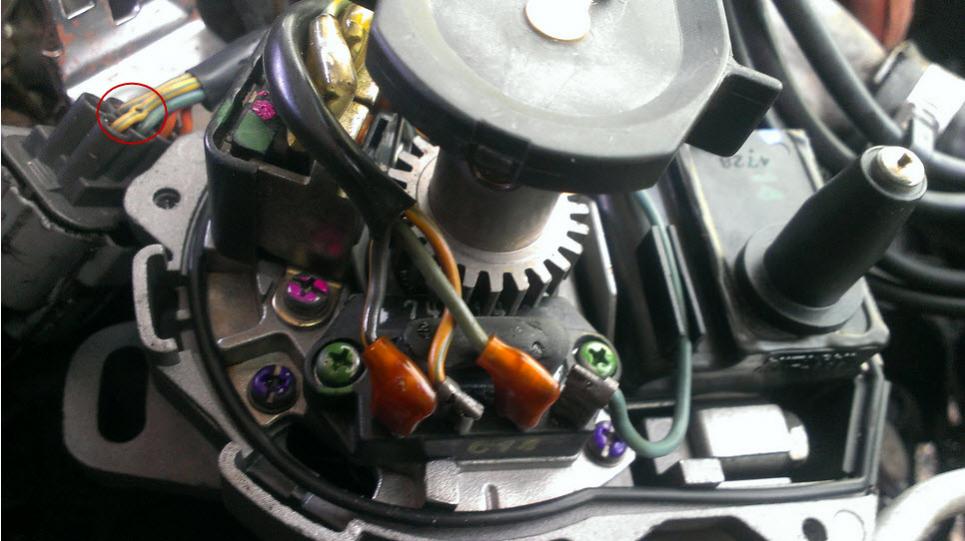

I noticed in your attached picture on JustAnswer, what looks like the wire insulation pierced in the Yel/Grn wire near the distributor. Backprobing is either using a backprobe set or using a thin needle or something and making contact with the metal terminal of the connector without piercing the wire in the back of the still connected connector. Care must be taken to ensure that the wiring does not get damaged. You can use something like a T pin, available at Walmart, etc., and backprobe. These pictures are just to give a picture of the concept of backprobing without piercing any wires.
