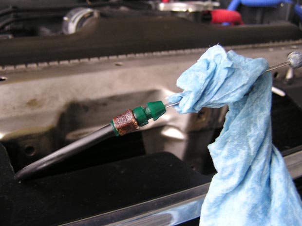

I have figured out why my hood won’t lock properly. It is not the latch as I believed to the point of almost going out and purchasing a new one. My hood is not closing properly because the locking mechanism of the latch is being maintained in the “open” position by the cable that is partially stuck inside it own sheave (see Latch 1 photo). All the dirt and other road grime had worked its way into the cable jacket. The stuck cable is pulling on the locking arm of the latch placing itself under excess stress. In time this stress can cause the cable to break.
Prior to removing the latch for cleaning I had adjusted the latch by moving it up a little with no success. I then removed the latch and attempted to lock the mechanism with the cable still attached. I was unable to lock it.

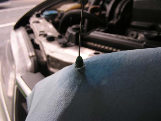

I removed the cable sheave from the holding slot on the latch and noticed how far the locking arm traveled (see Hatch 2 photo). I then pulled on the cable itself and was able to draw additional cable from its sheave. I then proceed to spray silicon into the cable sheave (see cable photo). I found it easier to wet a blue shop towel with silicone spray then squeeze it and allow the liquid to rundown into the cable sheave.
I would go into the car and pull and the hood release and back to the front the to pull on the cable to allow the silicon to work its way through the cable sheave (back-n-forth). After repeating this for a while I reassembled the latch. I then closed the hood it closed and locked with little more then its own weight as it came from the factory. I tried a few more time and I had one time that I had to close it little hard to get it to close. It is an old cable so I’ll have to see how it works in the coming days.
Jsam
You are correct in that if the hood does not lock simply push the latch lock lever (direction of arrow see Hatch 1 photo) which draws out more cable from its sheave. This however does not solve the problem. You need to get some lubricant in there or else over time the cable will break. Even lubing it up you may still need to replace the cable.
Jsam
