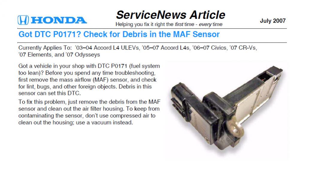

The MAF sensor is probably dirty. I've attached a picture of the location too.
For the P0171, check the Mass Air Flow (MAF) sensor first. Honda had a service news article regarding to check it first before spending anytime troubleshoot. CRC make a MAF sensor cleaner, available at most auto parts stores, even Walmart has it.
Leaks at the air intake which can affect the MAF sensor can also trigger the P0171.
Thanks. I changed the air filter and cleaned the MAF sensor with the CRC. Today is one of those days where the CEL is off so I don't know if it's worked yet. I'll keep you posted if anything happens.
