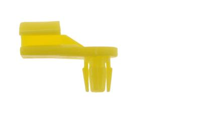

If this is the mix motor the clip will look something like this - just a general pic.
If you break it, they are like $3 at the dealer 79195-SF1-003
Notice the little black arrow on part D
