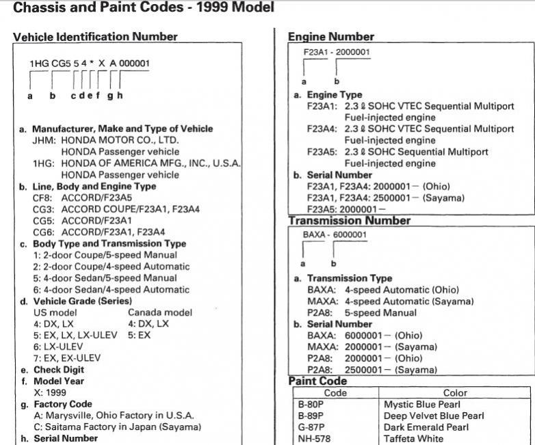

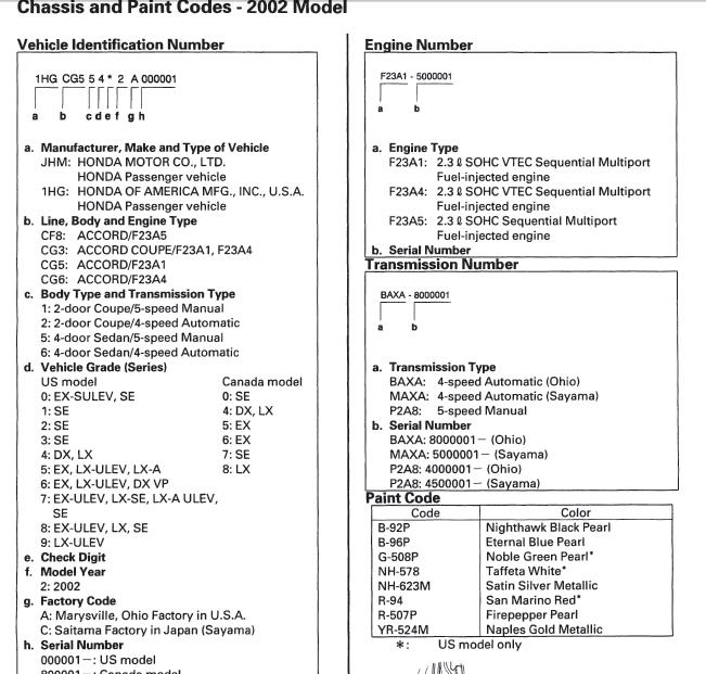

Do you have a non ULEV in an ULEV car?
If I'm breaking down the vin's correctly. That would be the case, not sure if that is the issue or not.
I read before of another member having issues with aftermarket knock sensor, replaced with OE and it was fine.
As I said, the fact that the engine is from a different car might not be the issue. The "short" block (everything below the head), I'm sure is the same, the difference between the ULEV and LEV is in the "systems" that "feed/control" the engine- intake manifold, injectors, O2's, exhaust manifold, ect...
