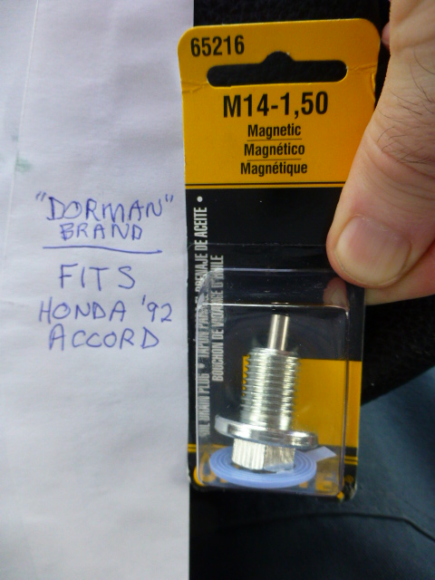

forgot that I took a photo before installation.

Oil was changed today at shop; there was some residue on magnet tip - not super much, but enough.
