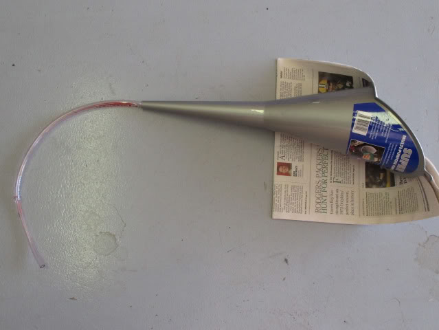

Yes you can fill ATF through the dip-stick tube and that's what I prefer over using the fill hole. I used a long funnel and series connected a couple different sizes of vinyl tubing to fill ATF on my 04 Odyssey.

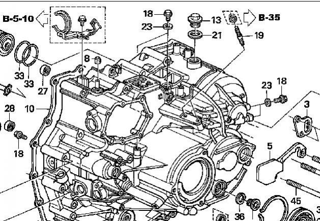

I am refilling the transmission through the dipstick tube, but I would like to know where the fill tube ("remove the fill plug and add fluid into the tube") is located. The owner's manual ('06 Accord Hybrid) has illustrations for every other fill location. Why not this one?
Old Jan 29, 2012 | 09:05 AM
Not 100% sure on the hybrid. From where the master cyl is, look down to the top of the trans case, behind a set of solenoids, there should be a 17mm bolt (might still have blue paint on it), the head will have something like "ATF" in raised letters. See #13 in pic.
EDIT: Updated the attached with a true '06 hybrid Accord pic.

Found it. Thanks. I don't know why my owners manual would call it a fill tube. Now I see why people fill through the dipstick tube. I think I could get the plug out with a socket extension, but there is no way I could get my hand in there to put it back.
