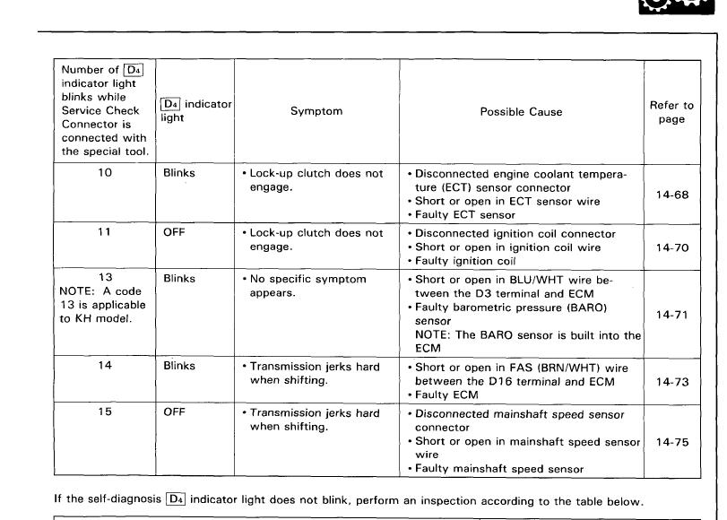

Are the codes TCU codes flashed by D4 or ECU codes flashed by Check Engine Light? The 90 manual I have shows no TCU code 13. If D4 is flashing this, it may be further confirmation of faulty TCU.
ECU code 13 is indeed barometric pressure sensor. The barometric sensor is in the ECU. My 90 Accord manual doesn't say anything about model variations.
IMO, the TCU codes (all of them) arise strictly from electrical faults sensed by TCU. The condition, bad or good, of the trans is not included.

Texashonda - thanks for your continueing help - have attached code chart for 94-97 autobox so you can see code 13.
Reset and reconnected everything today just on the off chance that fault may have fixed itself! However, exactly the same - everything works fine for about 2 minutes then drive completely disappears as if in neutral and fault codes return
I am fairly convinced the TCU is at least partly to blame, however when I contacted the company who offered to refurbish/repair TCU for £40 it turns out to be a bit of a con - the £40 is jsut for them to check board and all repairs needed are extra, so after you pay the £40 they have you over a barrel!!!
Not sure what to do now as the cost of a TCU from Honda UK runs into hundreds of pounds (car only cost £500) and even second hand from scrap merchants is around £100-150, if I was absolutely sure of TCU might go for it as apart from this autobox problem car is immaculate with loads of life left, hmmmm what to do
