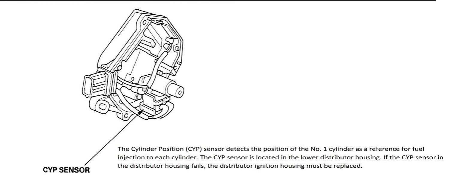

It looks like you broke the wire harness on the distributor housing for the Cylinder Position Sensor.
You can purchase the distributor housing (OEM or aftermarket) and then transfer the coil, igniter, etc. over (as long as those are not damaged). You do not have to purchase a whole distributor. The CYP sensor is not separately available, only available as part of the distributor housing.

That grey box was the plug that is part of the distributor. So getting a new distributor housing will fix the problem.
A new distributor housing is around $220 at the dealership. There are some discount OEM parts sites where you can get it cheaper.
You could find one at a junkyard for pretty cheap. car-part.com searches junkyards for parts and you can sort by price or distance.
