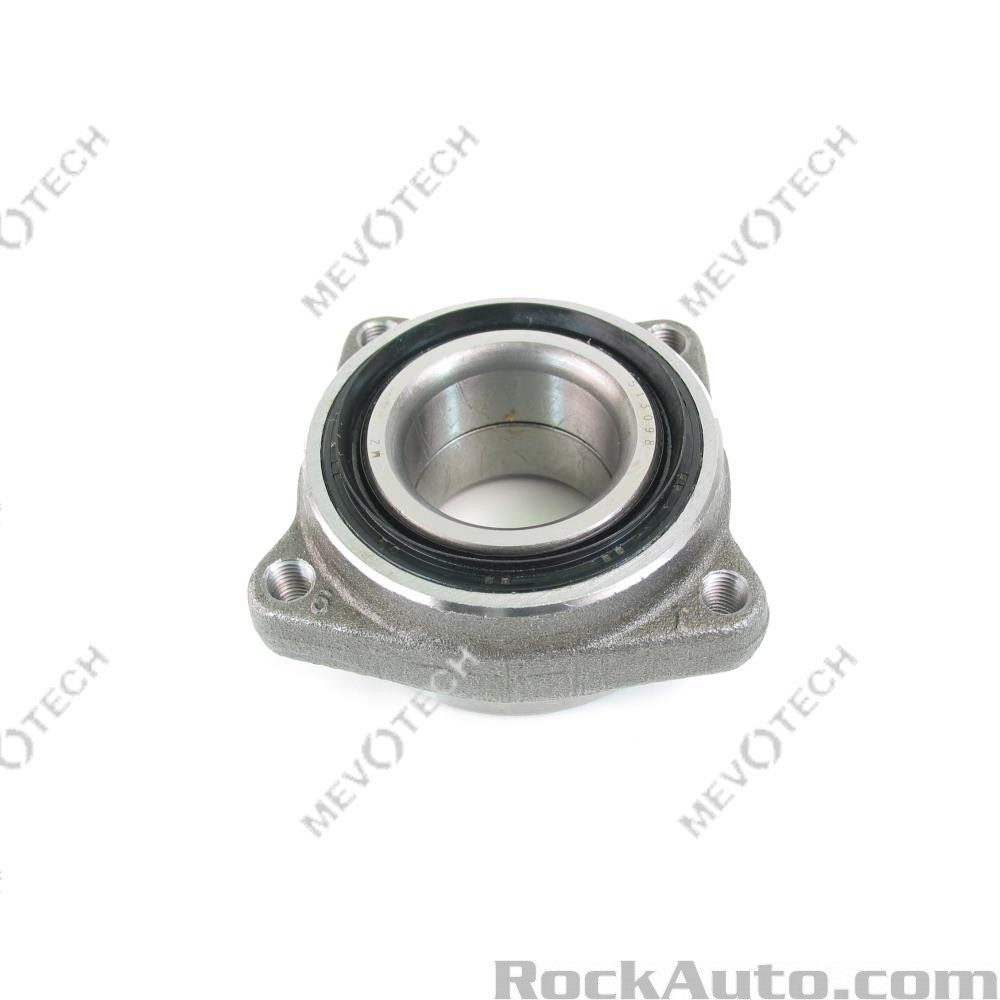

It may be difficult to extract the broken bolt ends or not. The part is available. see attached pic from rockauto.
With bolts broken the assy can be removed with hammer once axle is removed. It may be bound in the knuckle by rust (bigger hammer).

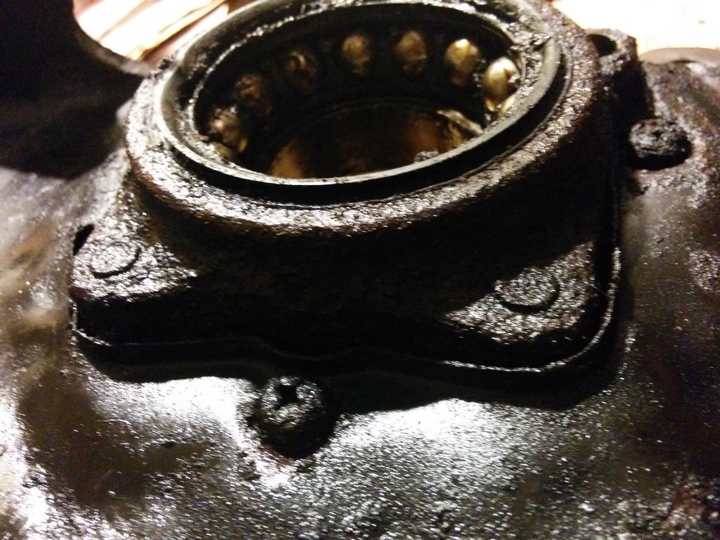

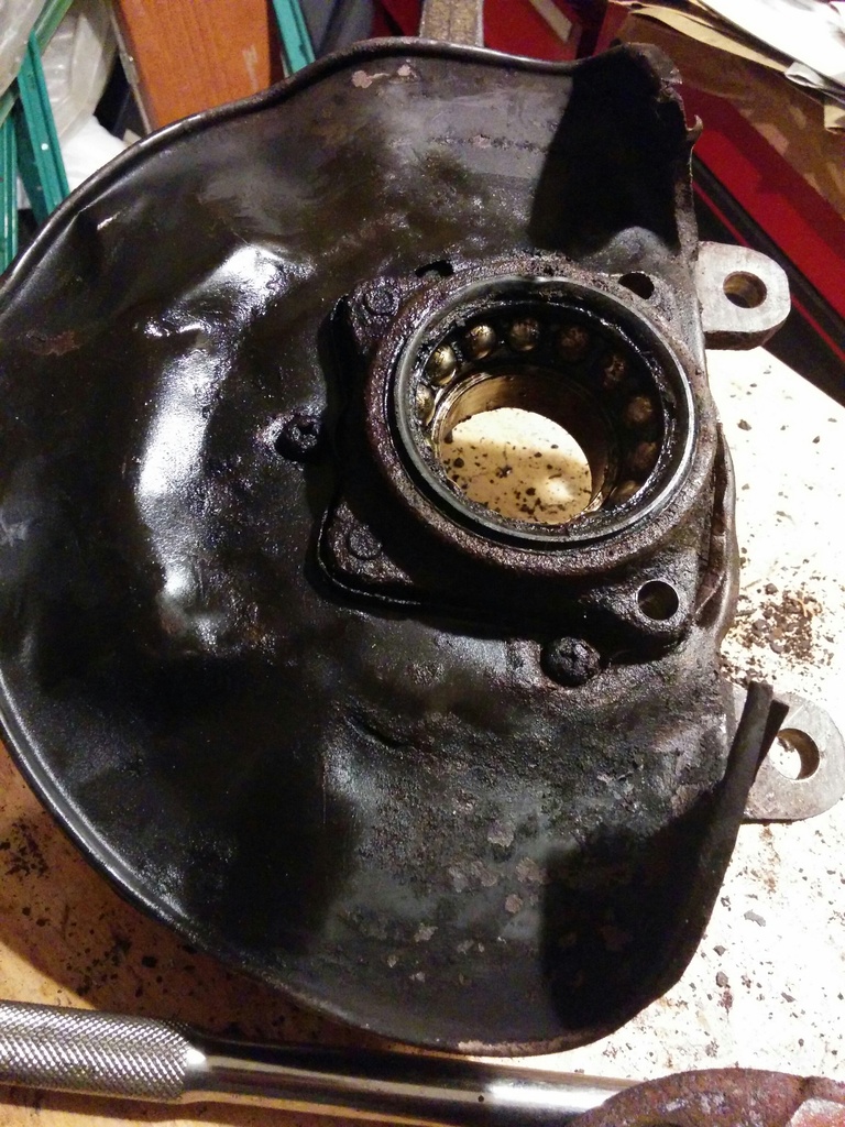

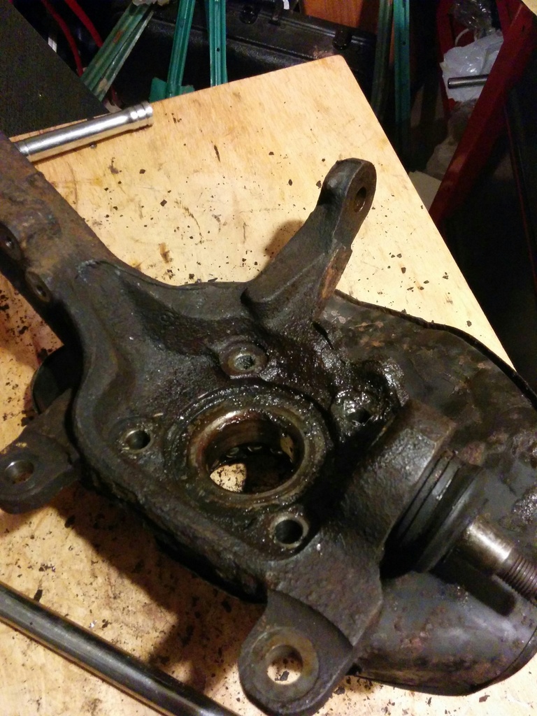

Thanks for helping me try to figure this out. I am stuck a bit again. After 4-5 hours of various...methods...I managed to separate the rotor/hub from the rest of the arm. However unlike I expected the bearing piece (that you suggested for me to buy) was so rusted onto the knuckle that instead of coming off the bearing itself came apart and now I need to somehow get the rest of the bearing out of the knuckle. I am mostly stuck with what kind of device I can use to hold the knuckle while trying to bash out the bearing - that shape is just very weird, I have no idea. Any suggestions would be appreciated!

I got a pipe coupling with a plug in it about the same size as the outer part of bearing and beat mine out
Old Dec 30, 2016 | 11:04 AM
An air hammer w/ a needle point may be able to reach the bolt ends and vibrate the hub from the knuckle. Move from one bolt to opposite diagonal bolt to gradually drive out hub.
Driving hub out with a large socket will require cribbing to support the knuckle so force is applied to remove hub from knuckle.
