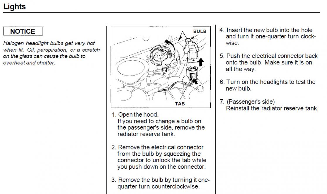

I am sure this has been answered a million times, but I do not see a thread for this. I have a 96 Accord LX and wanted to know how to change the bulb on the passenger side?? The headlight assembly is right against the battery and coolant reservoir.
Do I have to drop the bumper to change a bulb???

To change the headlight bulb on the passenger side, you can pull out the coolant reservoir first to give you more room. I usually remove the cap, then put my thumb inside the reservoir and fingers on the outside and pull straight up.
Instructions are in the owner's manual.

Easier to remove the battery (?) and res (pulls straight up)-maybe the air filter (using the 95 EX 4 cyl) top, housing or whatever that little vent thing is..again it pulls straight up.

Wasn't sure if the reservoir could be moved. Thanks guys for clearing things up for me. I will go get a manual and get that bulb changed.
