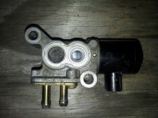

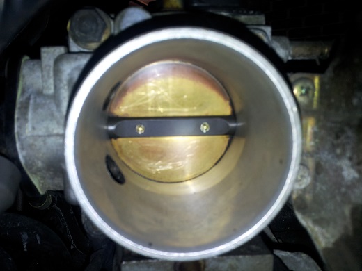

Yesterday I cleaned my IACV, throttle body bore and both sides of the throttle plates (after proper look, I saw that my TB bore and plate were not as clean as I said yesterday). You can see the after pictures. About the base idle - there are two marks between 0 and 1000 RPM, I set the base idle to be a little below the mark before 1000 RPM (is that 550 (+/-50) RPM?). Then I reset the ECU by disconnecting the negative terminal? I left it d/c overnight.
However this morning, when I turned on the car (starts off at about 1500 RPM) and let it warm up. At warmed up, the idle is just a little above the mark before 1000 RPM. So I turn on the A/C and the RPM drops (see pic), the car engages something, it rattles a bit and then settles (although I say it settles, you can still tell the difference from when AC was off)
I know the above scenario is not normal. Any help?

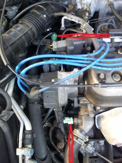

I have jumped both fan switches (see pictures) and both times, the passenger fan came on.
What next?

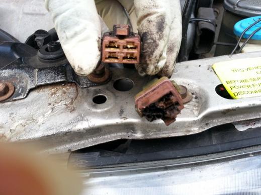

So I found both the Condenser Fan Relay (I'll call this CFR) and Compressor Clutch Relay (I'll call this CCR). I disconnected both relays and found that the CFR connector was busted (see picture). The previous owner removed these relays from their original location and zipped tied CCR to my PS Steering fluid hose while the CFR was just hanging off at the bottom . Took me a while to find CFR.
So I switched the connectors; CFR into the original CCR plugs connector, and CCR into the original CFR plug connector. Turned car on, turned A/C on and both fans worked . However when switched back, condenser fan wouldn't work.
Question now is, how can I fix the busted CFR connector? Any DIYs? And I guess a replacement CFR will be picked up?

CFR is replace-able. Check OEM and other sources. I would not try to repair.

Thanks. I will order a replacement.
