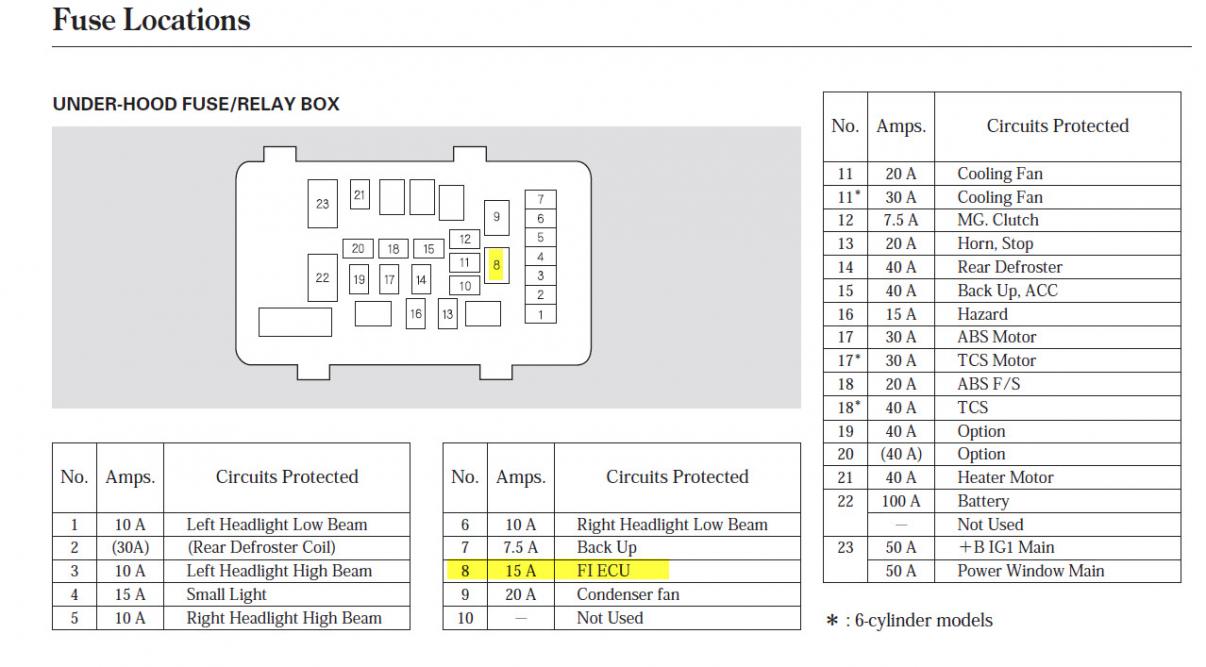

Also, check the ECU fuse.

I think I already checked that fuse but I'll double check. If it's not the fuse what else could it be? Could it be a bad relay?

I just checked the ecu fuse and it looks fine. The battery terminal and the grounds were clean and I made sure they were tight. I think the problem is electrical, something probally got fried. I appreciate everyones help but im really frustrated. I think I'm going to tow it to a mechanic.
