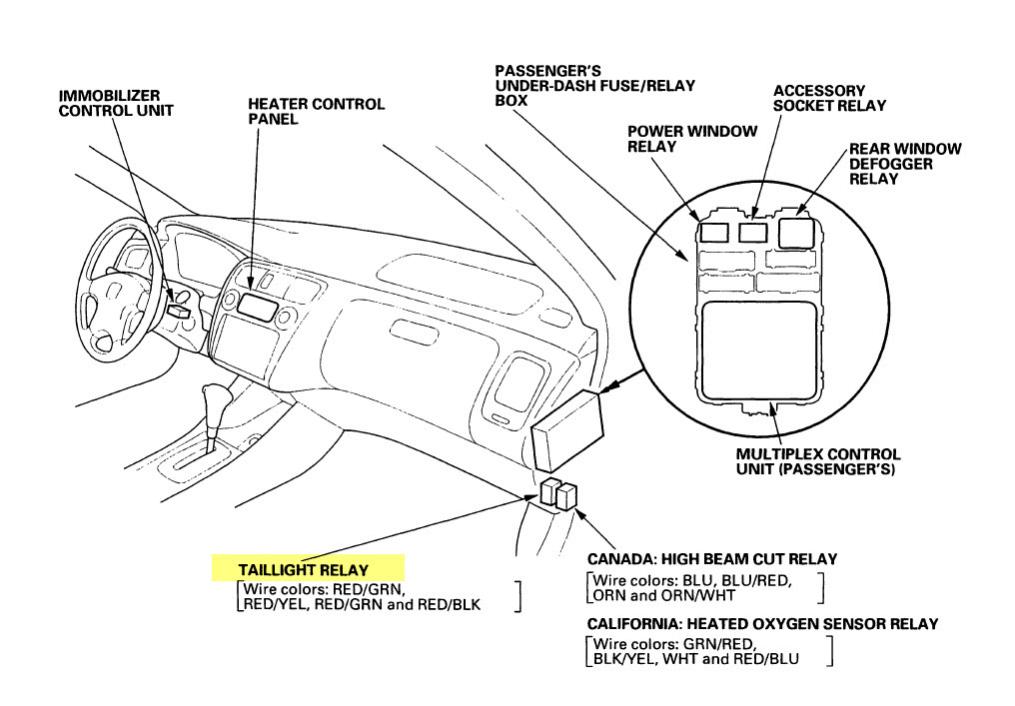

5. If you followed the video instructions and tried the jumper wire and the dash lights still doesn’t work, then we move on to our first test. Note: This first test is to narrow down the area of the problem and further tests will be performed after you post your results. – the first test does not necessarily mean the tail light relay is faulty, etc.
On your EX, you have a tail light relay located on the passenger side. Power for a lot of various small lighting has to run through this relay. If you have a voltmeter, you can test a few wires there to diagnose to narrow down the area of issue(s). You will want to backprobe a few wires. Backprobing is either using a backprobe set or using a thin needle or something and making contact with the metal terminal of the connector without piercing the wire in the back of the still connected connector. Care must be taken to ensure that the wiring does not get damaged. You can use something like a T pin, available at Walmart, etc., and backprobe. These pictures are just to give a picture of the concept of backprobing without piercing any wires.
  • At the tail light relay (with it stilled plugged in), with the voltmeter’s black lead touching chassis/body metal ground, use the voltmeter’s red lead to backprobe the Red/Blk wire at the tail light relay. There should be voltage at the Red/Blk wire with the combination light switch turned on (i.e., parking lights or headlights on). (Red/Blk wire should be a wire with red color insulation and a blk stripe.)
  • If no voltage in above procedure; with the voltmeter’s black lead touching chassis/body metal ground, use the voltmeter’s red lead to backprobe the Red/Grn wires at the taillight relay with the combination light switch on. There will actually be two separate Red/Grn wires there, one Red/Grn wire (terminal connector 2 pin) is coming from Fuse 10 in the passenger fuse box, the other Red/Grn wire (terminal connector 5 pin) will be coming from the driver’s multiplex control unit. There should be voltage.
Post the results of your testing and I will give further instruction on what to test next. Do not replace any parts yet. It may just need some wiring repaired.
Attached Thumbnails Car troubles-tail-light-relay.jpg   Car troubles-tail-light-relay-location.jpg
