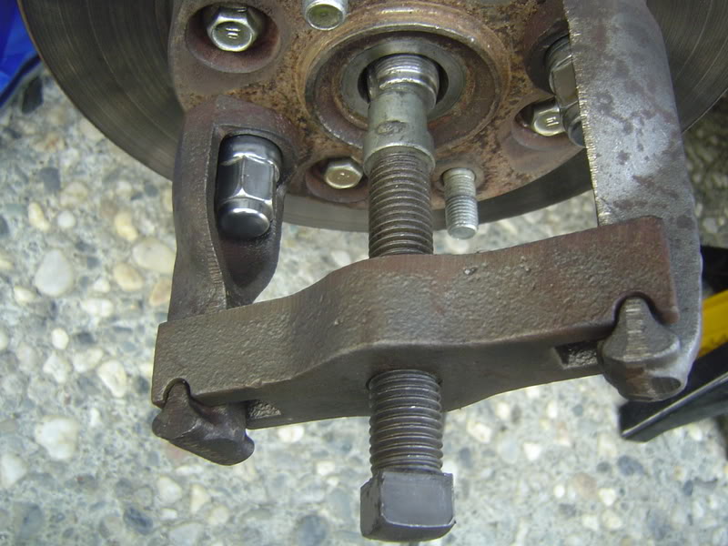

Is your set up the same as the one in this link?If so,you can buy the tool from JC whitney for like 35 bucks.
Heres the link for a 97...not sure if it can apply to your 94,but for my 96 it does.
http://i89.photobucket.com/albums/k2...u/DSC06928.jpg

I deleted the link...is the pic ok?
