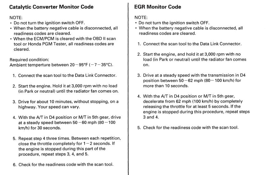

Old Sep 8, 2013 | 09:35 AM
I forgot about this yesterday. After you do the reset, you should let it relearn idle first. See the bottom part of the first post in this thread by Jim : https://www.hondaaccordforum.com/for...e-speed-38734/
Then for the readiness codes. That depends on "how you drive it". The one that will take the longest is the evap system.
Almost all of the others can be "set" by a few simple steps. See attached.....don't worry with the "connect scan tool".
