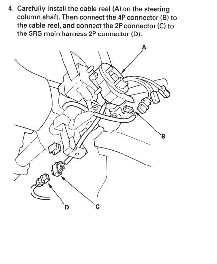

thanks its working fine now thanks guys it was a plug in the back that was missing ..thanks to poorman212 for sending me the pic !!!

I don't have a 2000 Accord manual and looked at a 97 Acura manual (similar). It shows 4 plugs; main SRS plug and 3 outlet plugs to horn, cruise, and driver's airbag. You can unplug main harness and check for continuity of each outlet plug.
Old Jun 5, 2012 | 10:21 AM
See if this helps.....be sure this is a 2000, the 2001-2002 are different.
some what thanks i dont see the 1 wires (1 on the side)
