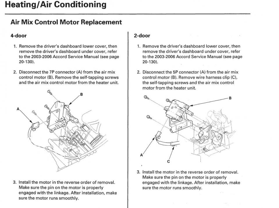

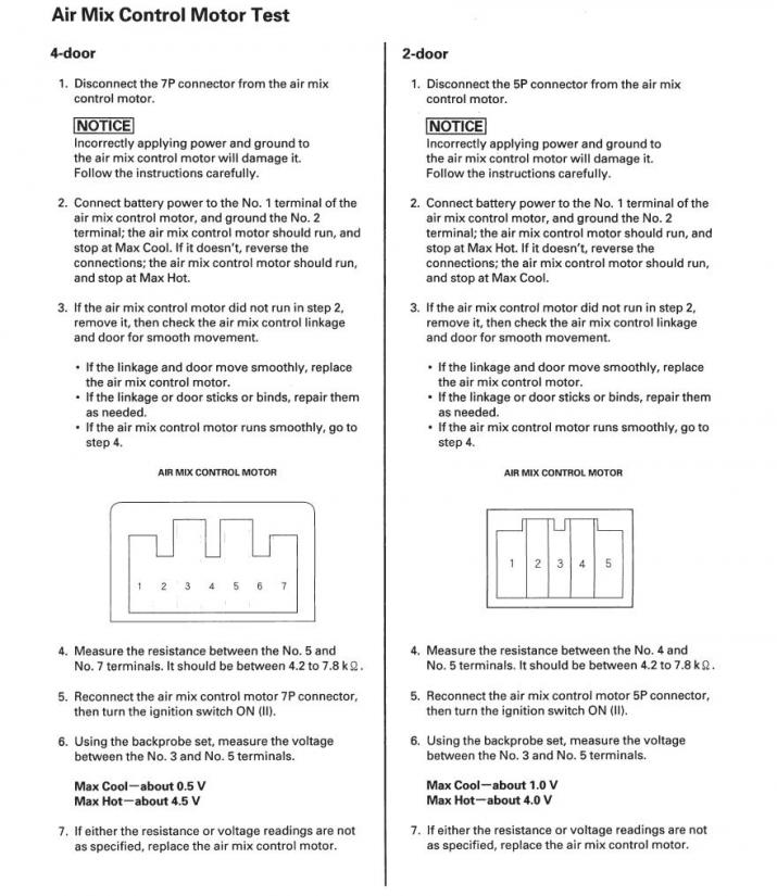

Sorry, kept thinking of the auto HVAC - Air mix motor.
Attached Thumbnails Code 3 HVAC problem.-7th-gen-air-mix-motor-test.jpg   Code 3 HVAC problem.-7th-gen-drivers-air-mix-motor-replacement.jpg

Do you know where the air mix motor is and how hard it is to replace?
Old Aug 17, 2013 | 11:57 AM
I'm always a fan of testing things........could be a simple as the linkage needs a little lube.
From the drivers floor board, look up towards the center console....I think I have a pic somewhere....will post it later once I find it.
To replace, that is in the second pic I posted......high level, a few screws and the linkage and done.

Thanks! I missed your previous post. i will run ths test today.

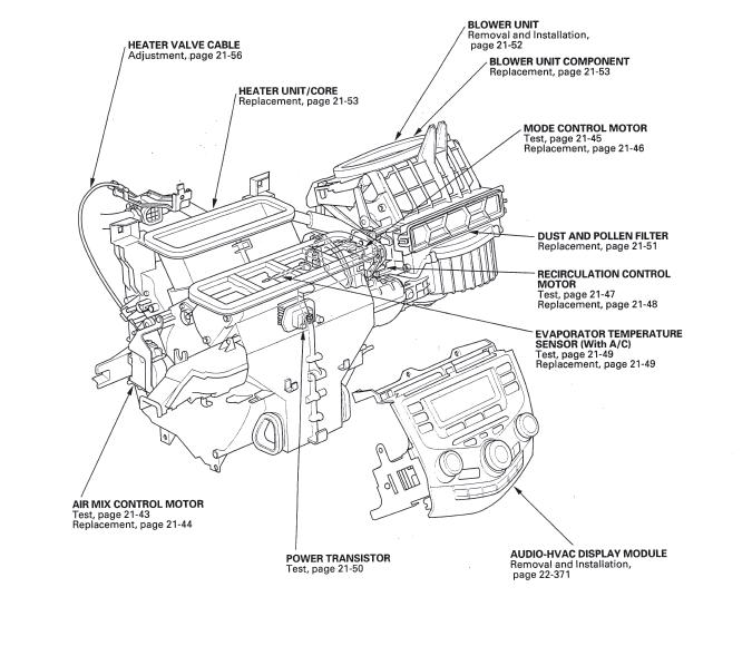

Old Aug 18, 2013 | 08:25 AM
Here is a general pic of the locations of things on the hvac box....
