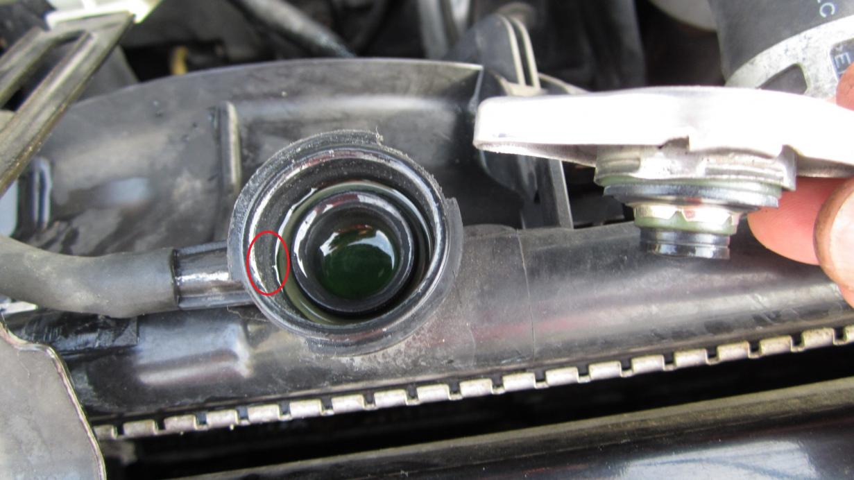

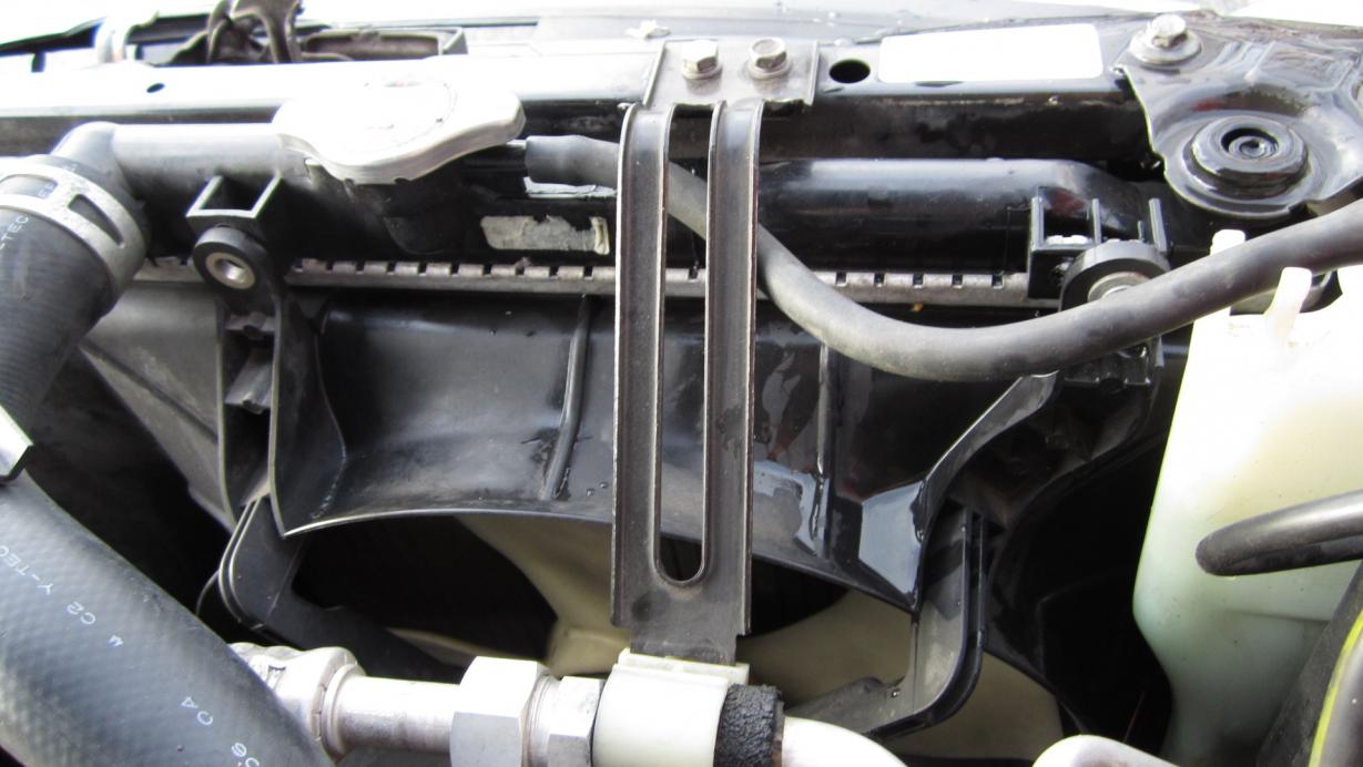

I pulled the hoses from the reservoir to check for blockage. Free air flow all the way up to the neck of the radiator, but the nipple on the neck of the radiator seems like it is eiter blocked or has very restrictive airflow.
I've included some pics, and from this photo it looks like the overflow bleed should come from the outer ring inside the neck, and there should be a hole where I have drawn the red circle.
1) Is the airflow through the overflow nipple of the radiator neck supposed to be highly restrictive? Or should it be relatively free flowing?
2) Can you tell from the pics if I have the wrong type of radiator cap?

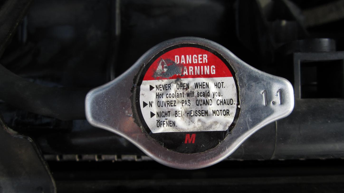

Looks like correct cap to me. It should have a pressure release of 14-18 psi. If you get coolant overflow at normal operating temps, then cap may be out of spec.

Another thing to look at is the very center disk on the underside of the radiator cap. It's a vacuum-break with a relatively weak spring. You should be able to easily move that disk to expose the center opening.
If that center disk is somehow stuck, or screwed up in a way to prevent it from opening, that would explain having a vacuum in the system on cooldown.

yes, new thermostat and hoses ... the system warms, circulates, burps as expected. Lots of heat inside the car. Temperature gauge always shows comfortably below the halfway point. On the radiator cap, the outer spring is resistant but gives when I push on it, and the center valve is easy to open and close.
There is just no airflow when I blow on the overflow nipple coming out of the radiator.
I edited my first post to point to the location where I think there should be an opening.
Is it possible that this is a manufacturing defect, that the hole was never drilled? !!
Can you pull the radiator cap off your car sometime and verify if you can see the hole there or if it's hidden?

Yes there should be a hole where you put the red circle. It's not a very big hole, are you sure it's not there? (You can see it firsthand, better than the photo)
And the way you're holding the cap, the edge of that innermost disk is visible. That should open easily by pulling downward. But if there isn't any hole for the overflow hose, that would explain everything.
