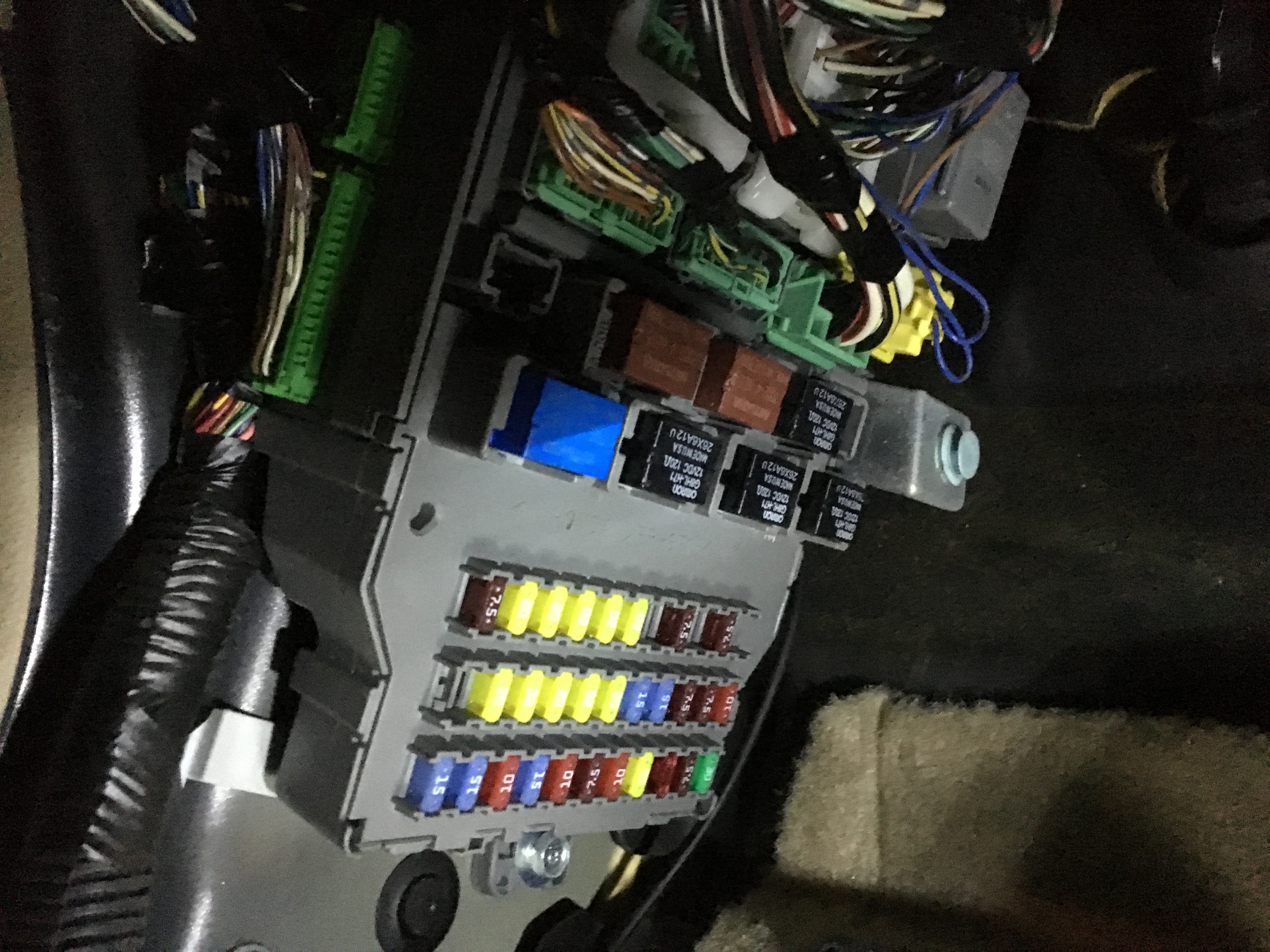

I have an update now that the car is in my hands. The clicking noise is coming from one of these relays in the left kick panel. I can make it click every time when I turn the key very slow, I keep turning the key very slowly, but so far, for me, the car starts every time when the key reaches a certain point. It started every time for her too, but some times she's in the parking lot for a few minutes. The noise is coming from one of these relays. I'm not really sure if there's anything wrong. I wonder if she just isn't turning the key all the way. Watch the vid, you can hear the "clicking" sound when I first reach the "start" mode, I keep turning the key very slowly until it reaches a point to where the car starts.

Look for the starter relay, if there is one

There is a starter relay, the forward black one, I swapped it with another relay that is of the same one, and it still does it.

Then I would replace the starter, if you are sure the battery posts are clean and that the battery is good.
