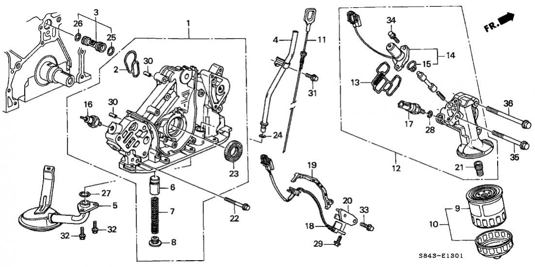

Old Mar 4, 2013 | 10:06 AM
Oil filter adapter is towards the front, so apparently the oil was dripping/blowing from their towards the back.
"More likely" is all good, but if you can actually SEE where it's leaking from, that's the best information.
