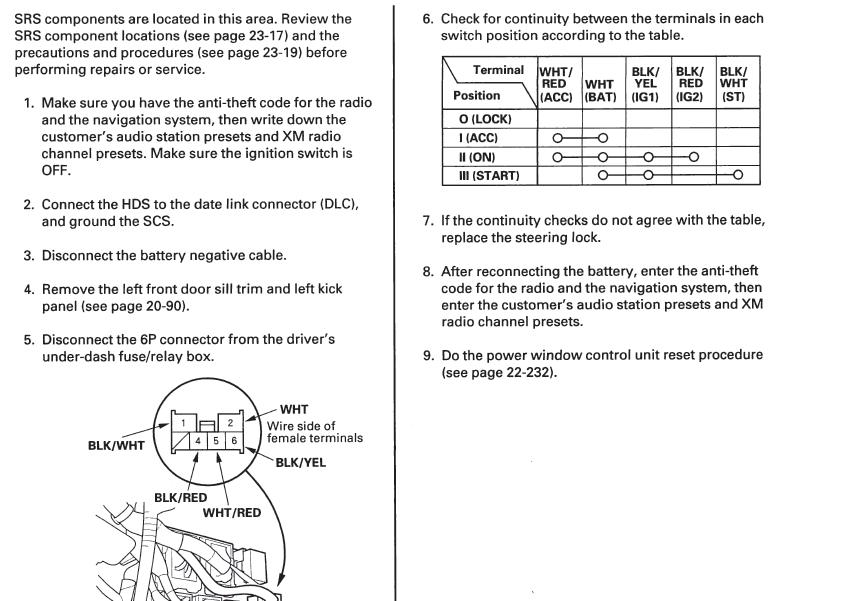

I got the Haynes Manual finally but I don't see anything in it about a way to test the ignition switch assy. It gives ignition system checks but nothing about testing the assy, its all about testing the battery, fuses, relays, and for spark. Is it not possible to check the actual assembly to see if its good?
Old Jan 20, 2013 | 09:59 PM
Please don't take this the wrong way but I would get a better manual...for $22 I bet you could get something better.

Can you tell me what repair manual that came from?
Old Jan 21, 2013 | 06:11 PM
OEM manual. Check automanualsource for an OEM emanual for $21.99.

Wow, I'm a genius! And I don't mean that in a good way. Thank you for the picture before I forget because I don't know as I would have found it in that manual anytime soon but I did download it. Anyway, I tested the connections last night and they all had continuity the way the manual says. Tonight however when I looked at the page in the manual I could see the whole picture and I relized last night I tested the connector attached to the steering wheel not the relay box. When testing the connector on the relay box as it says there is no continuity in any key position. Meaning the I have to replace the steering lock, correct?
Is it normal that there would be continuity at the connector on the steering column but none at the connector on the relay box?
Old Jan 24, 2013 | 12:18 PM
Switch assy is separate from lock assy. You need to replace the electrical switch assy, usually about $35 and readily available.
Check youtube videos for help on this. Lots of good videos of the process.
