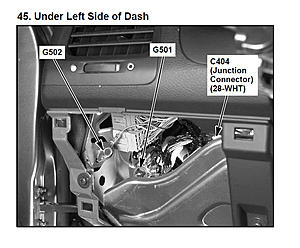

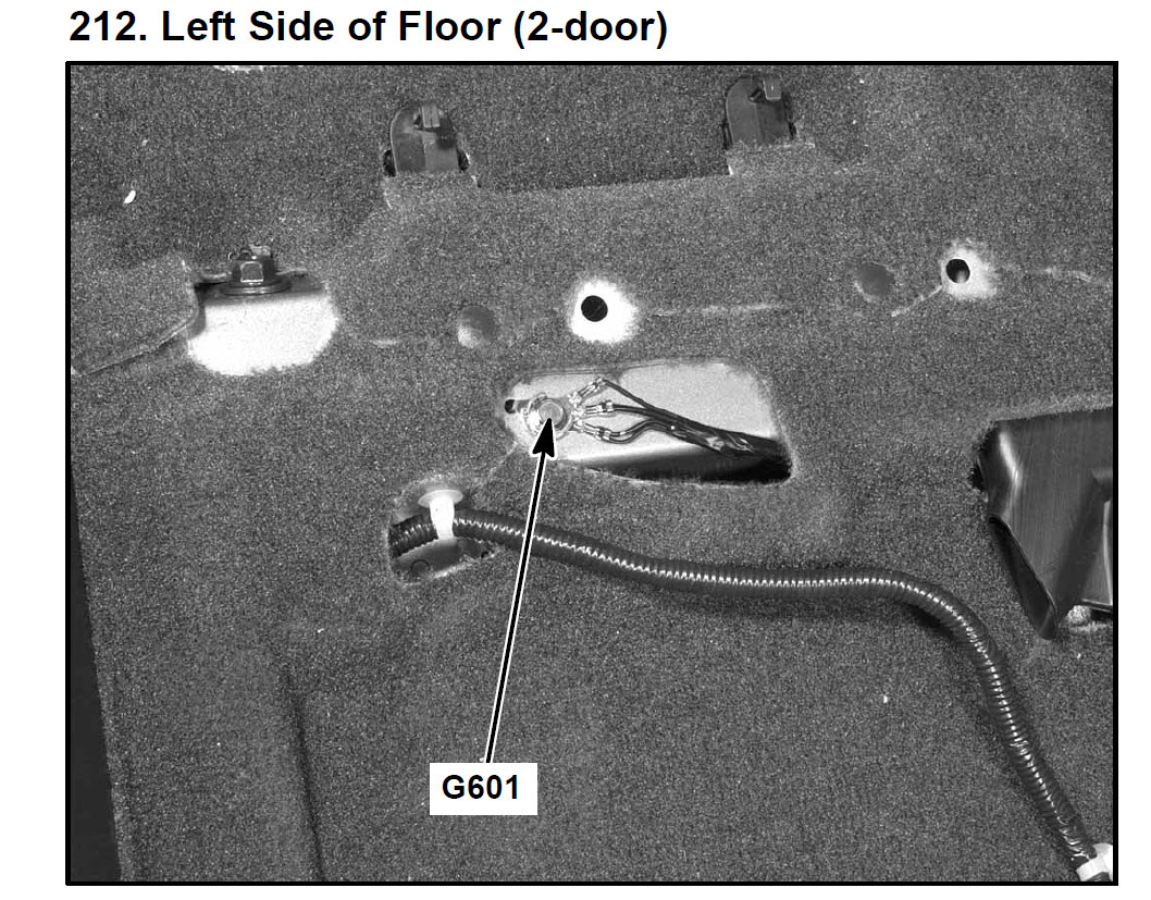

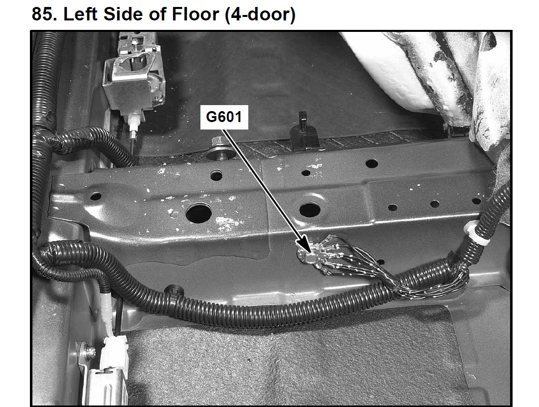

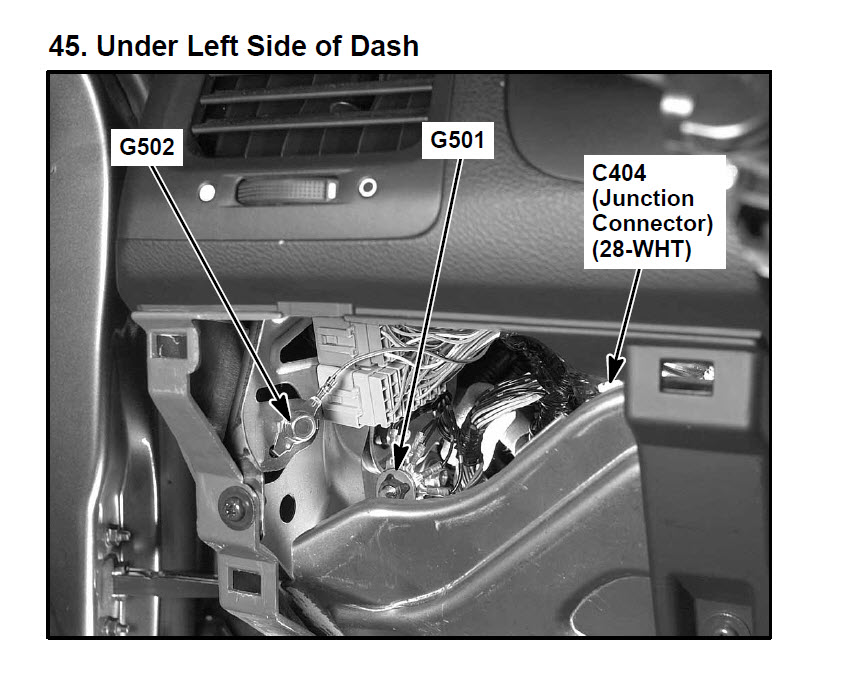

There are several control units that are part of the multiplex control system. Your symptoms are more likely related to the Multiplex Control Integrated Unit (MICU) that is integrated as part of the under-dash fuse/relay box.
The MICU may possibly be bad.
But, there are grounds wires (G601) under the carpet of the left side of the car that go to that MICU and also another ground wire (G502) under the left side of the dash that goes to the same MICU.
Could you clue me in as to where these grounds are? I looked under the carpet drivers side and didn't see on going under, but I didn't take it completely up and may have missed it
Old Oct 14, 2017 | 11:33 AM
See attached photos. G601 ground is different between 4-door vs 2-door.
