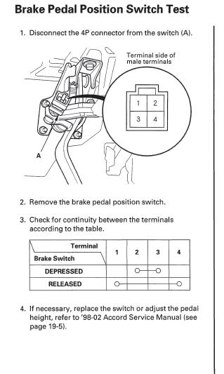

Old Feb 16, 2013 | 07:05 AM
The brake lights working DOES NOT eliminate the brake switch.
If the switch isn't adjusted correctly the brake lights will work but the cruise will not.
Need to test continuity from pin 1 to 4 on the switch when the pedal is not pressed.
